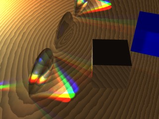

Someone requested an update on the photon mapping patch.  Here's a pic.  :)
Here we see three lenses lit by three light sources.  The middle lens
has photon mapping turned off (the default), so it casts normal filtered
shadows just like any other object.  If you look on the blue box, you'll
see light reflected from the bronze box.  There's also some light reflected
from the bronze box that goes through the lens nearest to the camera.
Image stats:
aa: 0.3
render time: 3:25
number of photons: 67,968
peak memory used: 3,004,062
-Nathan

From: ivfer
Subject: Re: Lenses
Date: 28 Feb 1999 18:01:39
Message: <36d9cad3.0@news.povray.org>
Nathan Kopp wrote in message <36D8E0E2.36503AC2@Kopp.com>...
The images are great, especially considering the small # of photons used.
A couple of questions:
1) Did you ever solve the problem with splotchiness when firing random
photons? If you're still using a scanning approach do you handle the case
where an object surrounds a photon source? You'd need to scan based on
spherical coordinates in that case.
2) Are you using wavelength dependent ior or are the r,g,b caustics due to
different positions of the lights? If you're doing wl-dependent ior, how do
you encode the light's spectrum in the photon? I punted and simply fired
multiple single-wavelength photons (jittered spectrum sampling) if the
target had a wl-dependent ior (and prayed that subsequent objects weren't
wl-dependent).
Thanks
Mike

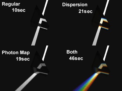

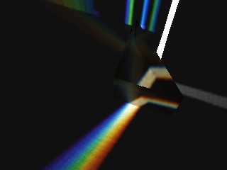

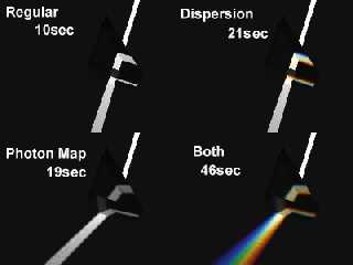

From: Nathan Kopp
Subject: Re: Lenses
Date: 28 Feb 1999 20:11:46
Message: <36D9E946.74261F86@Kopp.com>
No.  I use a jittered uniform scan.  And I always use spherical coordinates.
That way it provides even distribution of photons on the surface of a
sphere centered on the origin, which is more physically accurate (as
opposed to evenly distributed on a planar surface).
> wl-dependent).
The rgb caustics come from three lights in different positions.  This does
do wavelength dependent ior, too (images attached).  Instead of sampling
the spectrum randomly, I allow the user to give a list of wavelengths
(in the form of RGB vectors) that make up the light.  I use a modified
version of Daren Wilson's dispersion patch, along with your rgb->hue
conversion function to do the rest.
-Nathan
Download 'prism.jpg' (16 KB) Download 'prism2.jpg' (8 KB)
Preview of image 'prism.jpg'
Preview of image 'prism2.jpg'

Subject: Re: Lenses
Date: 1 Mar 1999 18:18:43
Message: <36DB2020.F2182654@aol.com>
It's amazing alright. How'd you manage the light reflection? I didn't
know this was part of it. The parallel rays/parabolic mirror thing is
possible then huh? And again that render time is extra-ordinary. I'll
pay no attention to the memory used.
> Image stats:
> aa: 0.3
> render time: 3:25
> -Nathan

From: Mike
Subject: Re: Lenses
Date: 1 Mar 1999 23:43:59
Message: <36DB796D.2931E516@aol.com>
I didn't think you'd be able to do something like THAT.  45 seconds?
Wow!
-Mike
> -Nathan
>  [Image]  [Image]
