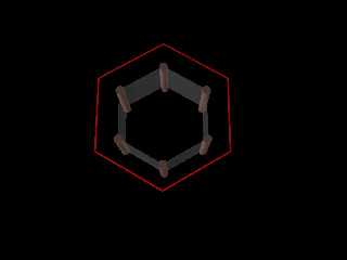

I have made a loop to render [X] sided extruded polygons for an
octaconal table, gazebo, etc...  It works fine exept now I need a way to
clip a box with the object for shelves and top.  As a somewhat newcommer
to POV I just can't seem to get this solved.  I have attached an image
and here is the source.  The red 'top' was scaled to move it away from
the main base object.  I now that clipped_by is not right but how to end
up with an octagonal piece?

Download 'extrude_poly.jpg' (14 KB)
Preview of image 'extrude_poly.jpg'
From: GrimDude
Subject: Re: HELP, table top clipped by object, HOW?
Date: 25 Feb 1999 00:51:11
Message: <36d4e4cf.0@news.povray.org>
Uh, use a prism/prisms? :)
GrimDude

From: Karsten Senz
Date: 25 Feb 1999 03:54:27
Message: <36D50FB6.A916E379@wi-bw.tfh-wildau.de>
you could define a cylinder at the origin with the radius r and do some
csg-differencing. The folowing code is untested and should at least give
an idea how to achieve what you are looking for.
Happy coding!
// tabletop
#declare tableTopsBottom  = 6.0;  // or DH
#declare tableTopsHeigth  = 0.5;
#declare tableTopsRadius  = 4.0;  // you could use your OR variable +
some offset
#declare numberOfSegments = 6.0; // or S
#declare segmentsAngle    = 360/numberOfSegments;
#declare segmentAngleRAD  = segmentAngle * pi/180;
//now some simple math to determine the size of the boxes
#declare boxHalfDepth = sin(segmentAngleRAD/2) * tableTopsRadius + 0.01;
#declare boxStartX    = cos(segmentAngleRAD/2) * tableTopsRadius;
#declare boxEndX      = tableTopsRadius + 0.2;
difference
  cylinder
    <0.0,0.0,0.0>
    <0.0,tableTopsHeigth,0.0>
    tableTopsRadius +0.01  // make it some bigger due to
coincidental(??) surfaces in csg
  #declare counter = 0;
  #while (counter<numberOfSegments)
    box
      <boxStartX,-0.01,-boxHalfDepth>
      <boxEndX,tableTopsHeigth+0.01,boxHalfDepth>
      rotate y*(counter * segmentsAngle)
    #declare counter = counter +1;
  #end
From: Gregoire Millette
Date: 10 Mar 1999 23:54:19
Message: <36E74C98.E14A2FE1@sympatico.ca>
Octagonol should be 8 sided and not 6 :)
Just thought I might point that out to you.
