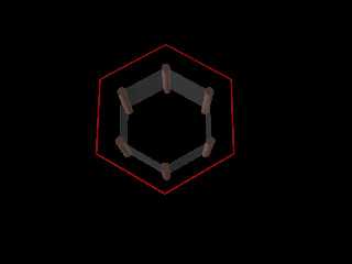

I have made a loop to render [X] sided extruded polygons for an
octaconal table, gazebo, etc...  It works fine exept now I need a way to
clip a box with the object for shelves and top.  As a somewhat newcommer
to POV I just can't seem to get this solved.  I have attached an image
and here is the source.  The red 'top' was scaled to move it away from
the main base object.  I now that clipped_by is not right but how to end
up with an octagonal piece?

Download 'extrude_poly.jpg' (14 KB)
Preview of image 'extrude_poly.jpg'
