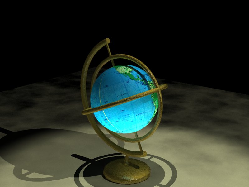

I got this idea from all the globe pics i have seen over the last few
weeks.....
the frame work is a CSG union of torii and cylinders with CSG difference
of a torus and cube. the Globe itself is just a sphere with a mercadies
(sp?) map in a spherical image mapping. the stand is a rotational sweep,
and the ground is a cube.....    need a little help on the image map of
the globe (it seems to be too light compared to the rest of the
picture).and also attached is the source code and inc file for the
textures...

I don't understand the use of the overly intense light (rgb 4) centered
inside the globe which has no filter/transmit and is using a phong_size
of 0 without the phong keyword. I checked this out using only a textured
sphere (no image_map) with and without a normal. When using a normal the
sphere lights up even though opaque. Then I tried an image_map, same
thing happens. Have you since removed any normal statement?
I thought perhaps you had one of the lights below the globe, yet this
isn't the case.
