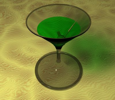

Just something I stirred up. It's my first post, so be gently. Comments,
as always, are appreciated. thank you.
---john.

Something is wrong here, KEEP it like that.
I actually felt sick after looking at you image, the viewpoint seemed
very disturbing. And I enjoy the effect, made me notice the image,
something to remember it by.
The table/wood will need another texture, in my opinion...
A very good glass and drink.
//Spider

Hmmm, hhhmmmmm....
Did you use 'merge' for the top lip of this glass? Looks like a torus
may be just unioned in or something. Difficult to tell about the rest of
it though, and the bottom has a shadowy ring as well though this can be
caused by a wrong elevation from table surface. Keep in mind I'm just
throwing out thoughts, no criticism intended.

Look a bit similar to something PC Plus did a while back, only they choose to
not have green martini, can't imagine why.
    Graham.

Actually there is a torus on the top lip and the bottom. Made the edges stand
out more. The glass is a bezier patch and it didn't have much of a top or bottom
edge.

That explains a lot, the main glass part being a surface-only and not
having thickness. Makes sense now about the way it looks. Couldn't you
double up on the bezier and inverse it's surface to make it have a
thickness? Might be better, and might not, with refraction involved.
It's a pain to get things lined up right but if you did that and also
clipped the toroids where they meet the beziers it would have a truer
look.

wouldn't a rotational sweep work?
