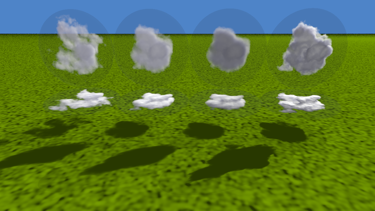

You will hardly believe it, but I have tried clouds in the last few days, see
result in the picture. Several clouds in side view and from above, with slight
changes.

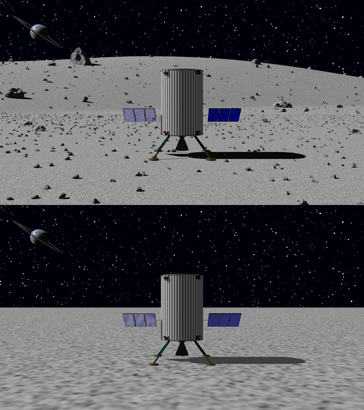

I haven't tested the clouds so far, but there is a rock generator on the page.
It randomly creates meshes for handsome, non-round rocks, with which I have made
my moon surface a bit prettier.
https://www.geocities.ws/evilsnack/inc.htm
The stones in the picture are all of one mesh, just different sizes and rotates.
My lunar surface is not perfect, but out of the Ugly-Top-3.

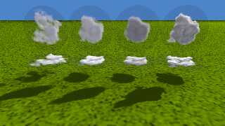

> Thanks for the links! Especially the first one, the tutorial is very helpful.
> changes.
> > *(sorry I forgot a point, but I'm sure the next iterations will refocus :-P )
> You forgot about 100 points :)
> I have so many ideas what to do.
> I could work on it for the next years.
> Ma
The cloud on the right , I suppose has the highest quality settings and render
time? It looks much better ... But if the one directly on its left is much
faster, it is still quite an acceptable result ! Maybe there is a bug, but we
see the bounding sphere with a darker shade... This may be a problem. have you
played with RGBF vs RGBT vs RGBFT for colors? also if you use both a scattering
and absorption, maybe using just one of those would suppress the issue?
Its a test-enviroment only.
The clouds differ in certain parameters and the random numbers used.
With this I want to find out which settings looks good.
For the right two, this are some parameters:
transmit: 0.9; turbulence: 0.5; scattering: 10
transmit: 0.9; turbulence: 0.8; scattering: 20
The sphere around is intentional.
If you make the media inside the sphere to big, the cloud gets cutted and that
look not good. Its a simple transmit I have to increase from 0.9 to 1.
Haven't finished it yet, it's still under development.
Has something else come up again :)
