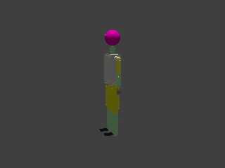

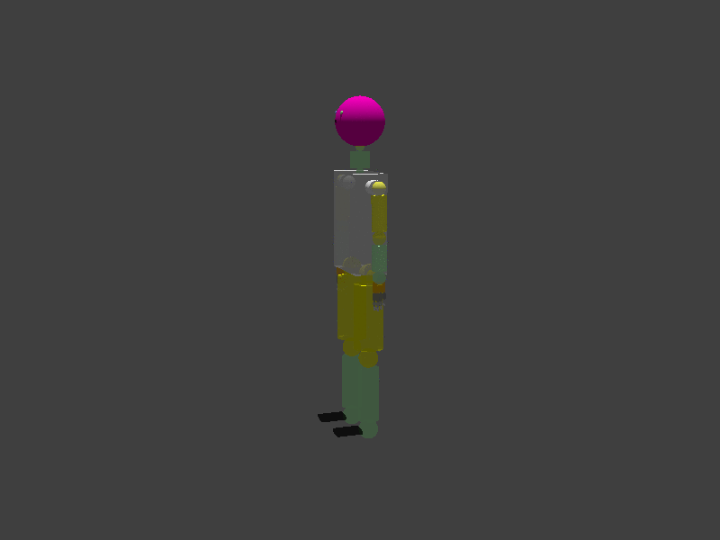

> I have also tried my hand at a humanoid robot, but the work did not stop and did
> not stop. But I would love to have one, or even a human figure. Wouldn't have to
> be lifelike. Better a little comic than badly realistic.
 The robot was one of the my first. I was still trying to set up the frame to
frame pose animation and get things organize. A Robot is a complicated object.
And to get one moving even more complicated.
 There's about 60 variables to make a robot. So I cut a robot into 3 parts
Body,Face,Hands. Each of these have their own pose files and object files. The
object file would take the pose variables and make the part.
 I better watch it or I'll write a whole page of nothing but how to build and
animate robots. To make a long story longer. I have to say I have a Robot
Factory now that can combine different bodies,heads and hands into a BOT and
then animate it. But I'm never satisfied I keep adding on to it.
I solved so many really tricky problems one after the other, only to find that I
hadn't even done a quarter of the way.
It started with from where to where build it up. This affects how it behaves in
not-standing positions (e.g. leaning to the side, jumping,...) and how he can be
controlled.
And then, of course, the appearance, how the individual parts can be human-like.
And the damn skull, I hadn't even touched it yet.
And... and... AND...

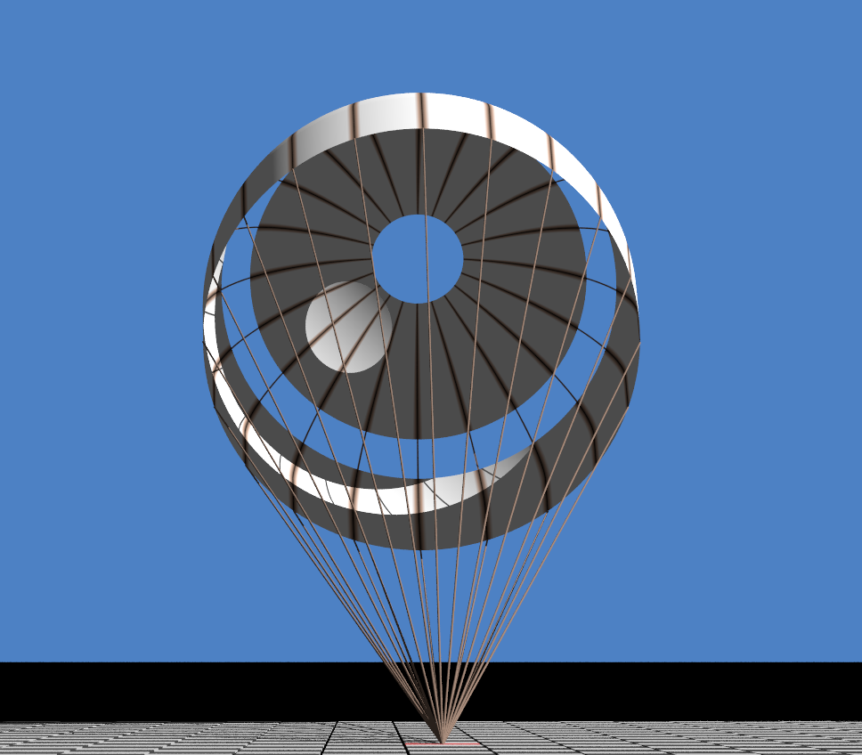

> The parachute would be cool, but please please don't waste hours and days. Maybe
> I won't use it or only in x months. If it's easy to extract - great, if not,
> don't do it.
It was very easy and small. Here it is:
 #declare PPig=pigment{radial color_map{[0 Black][.1 Tan]
                    [.3 rgb<.9,.9,.85>][.6 rgb<.9,.8,.85>]
                    [.9 Tan][1 Black]}
                    frequency 20}
 #declare Para= union{sphere{0,4 translate y*2
                    clipped_by{ box {<-4.1,4.4,-4.1>,<4.1,5.9,4.1>}}}
                    clipped_by{ box {<-4.1,3.5,-4.1>,<4.1,2,4.1>}}}
                    cone{y*2,4,-y*.25,3.9 open}
#declare ParaChute=
 union{
  object{Para pigment{PPig} translate y*50}
  sphere{0,1 scale<1,.25,1> translate y*25 pigment{rgb<.25,.15,.25>}}
 //cords
   #declare Cnt = 0;
  #while (Cnt < 360)
   cylinder{0,<4,20,0>,.05 rotate y*Cnt pigment{Tan*.5} translate y*30}
  #declare Cnt = Cnt+20;
  #end
   cone{y*25,.15,y*31,.2 pigment{rgb 0}}//short link
   cylinder{0,y*30,.15 pigment{rgb 0}}//long link
Straight from the code, It is fairly long 50 or so POV units.
Have Fun!

"Leroy" <whe### [at] gmailcom> wrote:
> And don't worry about the skull. One day when less expected, Wham it'll come to
> you.
I worked far longer than week on the robot AND THAT DID NOT HAPPEN !!!
Parachute successfully opened!
I fixed some small errors (missing cords in the gap, ...) and will make it more
variable in the next days, but so far the chute looks cute :)
Will send you the code when ready.
Thanks for that.
To build that from scratch would cost much more time.
Ma

From: Maetes
Subject: Re: Tussi - Flight No. 2
Date: 6 May 2025 10:00:00
Message: <web.681a153c9555a19522e4b3f730225ff5@news.povray.org>
Here the code for now.
Maybe I will do some more in the next days.
Gr
Ma
Download 'leroy_chute.zip' (439 KB)
