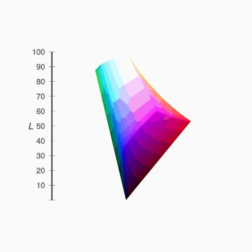

If I rotate the camera 90 degrees around the x axis, the isosurface
disappears.
Mike

What's weird is that the "missing" area perfectly fits the dimensions of
the bottom face of the cube used in the contained_by clause.
Anyway, I tried max_gradient 1000, and am now trying 10000. Not usre how
long it will take however.
Mike
> disappears.
> Mike
I increased the max_gradient to 10000, and there seems to be no improvement.
Mike
