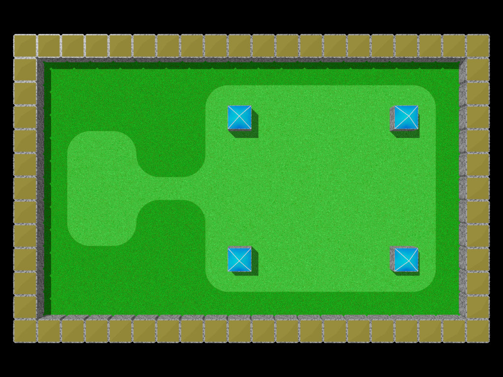

Each stone (Oxyd or non-Oxyd) essentially is a box of 1 by 1 by 1 units
defined with its lower left front corner at the origin.
Attached is the basic layout of the scene (lower left corner: <0, 0, 0>,
upper right corner: <20, 1, 13>), and when I start animating the ball at
a speed of 0.1 and starting angle of 60 degrees, first all goes fine,
the ball is reflected from the northwestern Oxyd stone (those with the
blue pyramidal roofs) and then heads towards the northern stone wall -
but shortly before it hits, a strange thing happens: the ball starts
moving parallel to the z axis and goes right through the wall rather
than being reflected!
What did I wrong? Do I have to post all include files such as pigments,
finishes, textures and objects for you to understand (and perhaps solve)
my problem?
See you in Khyberspace!
Yadgar

From: Le Forgeron
Subject: Re: POVigma: I just can't get it right!
Date: 28 Aug 2015 12:46:08
Message: <55e09050$1@news.povray.org>
Hash: SHA256
Le 27/08/2015 21:45, "Jörg \"Yadgar\" Bleimann" a écrit :
> #if (ballpos_next.x > xmin & ballpos_next.x < xmax & ballpos_next.z
> > zmin & ballpos_next.z < zmax) #declare dir = 360-dir; #declare
> hit=1;
* that's seems to detect a pinball's hit: ball hitting a nail on its
center.
* 360-dir is not the opposite direction.
hitting a bumber to get the opposite direction: dir = (dir+180)%360
You should detect walls' hit, and there is horizontal walls and
vertical walls. Both are harder to handle with a single dir variable.
Horizontal wall, reflecting the vertical component.
Vertical wall, reflecting the horizontal component.
Assuming 0 is North, 180 is South, 90 is East.
Horizontal wall: 0->180, 180->0, 90->90, 270->270, 30->150, 80->100
Vertical wall: 0->0, 180->180, 90->270, 270->90, 30->330, 80->280

From: "Jörg \"Yadgar\" Bleimann"
Date: 28 Aug 2015 22:40:36
Message: <55e11ba4@news.povray.org>
Hi(gh)!
which would yield the formula; dir = 180-dir
equalling dir = 360-dir - or just dir = -dir
Meanwhile I found out that my conditions left out the (rare) case that
the z coordinate of the ball's position in the last frame before
"entering" a stone is equal to that of the stone's southern face... I
fixed this (and also re-activated the branch for the vertical walls) and
now it runs fine (see attached video)!
Thank you for motivating me!
Yadgar

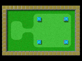

Date: 29 Aug 2015 12:02:06
Message: <55e1d77e@news.povray.org>
Hi(gh)!
And I thought I got it right... forget about it! While with speed=0.1
and starting angle=60 degrees all went fine, with speed=0.25 and
starting angle=340 degrees, at frame 219 the script starts to behave
bizarrely. As you can see in the attached video clip, the ball bounces
off a non-existing "horizontal" wall and then moves through the eastern
wall...
This is the collision detecting routine:
#declare rows=0; // check for collision with any stone
#while (rows < LevelLength)
   #declare cols=0;
   #while (cols < LevelWidth)
     // #warning concat("row: ", str(rows, 1, 0), ", col: ", str (cols,
1, 0))
     #if (layer2_array[rows][cols] = 1 | layer3_array[rows][cols] >= 20)
       #declare xmin=cols-0.35;
       #declare xmax=cols+1+0.35;
       #declare zmin=rows-0.35;
       #declare zmax=rows+1+0.35;
       // horizontal obstacles
       #if (ballpos_next.x >= xmin & ballpos_next.x <= xmax &
ballpos_next.z >= zmin & ballpos_next.z <= zmax & (ballpos.z < zmin |
ballpos.z > zmax))
         #declare dir = 180-dir;
	#declare hit=1;
	#break
       #end
       // vertical obstacles
ballpos_next.z >= zmin & ballpos_next.z <= zmax & (ballpos.x < xmin |
ballpos.x > xmax))
         #declare dir = -dir;
	#declare hit=1;
	#break
       #end
     #end
     #declare cols=cols+1;
   #end
   #if (hit)
     #break
   #end
   #declare rows=rows+1;
#end
These are the values at frame 219:
xmin = 18.65
xmax = 20.35
zmin = 3.65
zmax = 5.35
ballpos = <18.6344,0,4.38568>
ballpos_next = <18.7199,0,4.15076>
Now let's check both #if conditions:
Horizontal ("west-east") obstacles:

Download 'povigma_level0001_topview_0-25_340_newtexture.mp4.mpg' (1040 KB)

Instead, I now simply set cols and rows to LevelWidth and LevelLength
respectively after a detected collision, so that the nested loops both
come to an end...
...now the ball at least does not go through the wall anymore - but
instead, it is reflected in a somewhat strange way off the eastern and
southern bordering wall - see attachment!
This is not entirely absurd, as the border stones are beveled at the
corners, unlike the Oxyd stones - but the bevel angle is 45°, and the
ball hits always at angles which are not multiples of 45°, so it can not
be reflected this way...

...and it is the same like before!!! (see second attachment)
I hardly have words anymore for this... it's so frustrating... so
