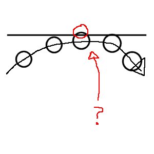

What I was talking about now in more detail:
If you shoot a particle in an angle, and the position calculated
for the particle does just not touch the ceiling, but the radius
of the particle does, how do you do that?
I've attached a crude image that shows what I mean.
Do you do some extra-trace()s and do a rough check of the near
vicinity or what?
Download 'path.jpg' (9 KB)
Preview of image 'path.jpg'
From: Rune
Subject: Re: Particle Algorithms
Date: 8 Dec 2001 15:11:24
Message: <3c1273ec@news.povray.org>
> calculated for the particle does just not touch the
> ceiling, but the radius of the particle does, how do
> you do that?
My particle system does indeed only do collision detection using the center
point of the particle as reference. I don't think there's much I can do
about that unfortunately...
Rune

From: Marc-Hendrik Bremer
Date: 8 Dec 2001 15:42:41
Message: <3c127b41@news.povray.org>
Rune schrieb in Nachricht <3c1273ec@news.povray.org>...
Couldn't you allow user defined collision detection macros, as you allow
afaik user defined objects? Most of the time a particle is short enough to
test just the centre IMO, but if one wants to use bigger "things", one
should also know where are the best places to test for intersections.
Just my 2 Pfennige,
Marc-Hendrik
From: Tim Nikias
Date: 8 Dec 2001 17:38:52
Message: <3C129615.8BAE3640@gmx.de>
Just a simple idea I had:
If you have the direction the particle is heading, why don't you do a
"axis-check"?
Example:
Particle flies in x-Direction.
You also check some angles which differ from original angle up to
90 degrees or so.
It's like creating a field-of-vision for the particles direction and looking
for intersections there.
On the other hand, that might become pretty parsing-intensive...
Perhaps the simple solution will work until someone has found some ingenious
way...
By the way: I've just downloaded the POV-Ray3.5 Beta 8 and am making
myself comfortable with it. Perhaps we'd see some "neat awesome-action-packed-
particle-animation" of *my taste* soon...
No offense, just kidding.
Tim
From: JRG
Date: 8 Dec 2001 18:01:41
Message: <3c129bd5$1@news.povray.org>
In my animations I use the centre of the particles and its radii to
calculate collisions along its velocity vector.
To avoid the problem you're showing here, I would use four more trace()s
along the same direction but starting from the frontier of the particles
rather than from the centre. You have to cover its envelope along its
velocity direction. I will try this and post the results as soon as I have
some time (I haven't raytraced for four days :-(
Jonathan.

From: Rune
Date: 8 Dec 2001 18:05:22
Message: <3c129cb2@news.povray.org>
> why don't you do a "axis-check"?
Yes, and even so, it's not very precise. That's why I don't like it.
And in most of the simulations I do, it won't make a difference anyway.
Remember that solid objects is just one out of many uses. For liquids, fire,
smoke, sparks etc. it doesn't matter at all.
> By the way: I've just downloaded the POV-Ray 3.5 Beta 8 and
> am making myself comfortable with it. Perhaps we'd see some
> "neat awesome-action-packed-particle-animation" of *my taste*
> soon...
Haha, I'll look forward to that. :)

From: JRG
Date: 8 Dec 2001 18:10:31
Message: <3c129de7@news.povray.org>
No, the direction has to be the same. Think of your particle as a
sphere_sweep: you simply have to trace() from the centre and from some
points of the diameter normal to the velocity direction.
Jonathan.
