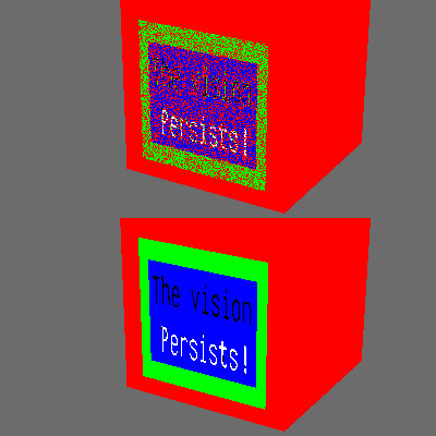

While working on a renamed and refurbished material_map{} feature for
the yuqk fork, ran across a bug where non-indexed / non-palette image
was - by numerical noise - sometimes slipping into an indexed state of 0
when interpolation was used. This happening no matter whether the base
image was indexed or not.
The bug traced to two functions in imageutil.cpp called
InterpolateBicubic() and Interp(). These are general routines so the
exposure touches any code which looks at the calculated 'index' value to
decide later actions.
The fix I used was to apply rounding rather than a cast to int when
returning the index value - which is always calculated alongside the red
/ grey color channel. (Yes, the index values themselves are interpolated
too for actual indexed images)
In InterpolateBicubic() change:
   *index = (int)tempIndex;
to:
   *index = (int)std::lround(tempIndex);
In Interp() change:
   *index = (int)temp_index;
to:
   *index = (int)std::lround(temp_index);
Find attached a sample scene for v3.8 beta 2 and an image where the top
portion shows noise from the bug and the bottom being the yuqk fork's
current output for the same set up with the fixes above applied.
Bill P.
Download 'image_indexed_textures_v38.pov.txt' (2 KB) Download 'material_map_bug.jpg' (198 KB)
Preview of image 'material_map_bug.jpg'

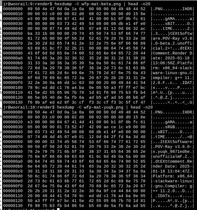

Thanks for the feedback. I think I need to tweak my documentation on
gamma. Up front I recommended it not be used because I assumed these
'indexed aimed' images would be written at a file gamma of 1.0 where the
red channel was used, but you're right, ultimately gamma while reading
an image file needs to match the gamma encoding for the image (*) when
it was written. Excepting indexed images, for which the gamma settings
should not matter.
(*) - IIRC the default srgb set up with png files for recent official
v3.8 releases has an issue where the srgb block is not being written.
This was fixed in the yuqk fork.
Did you intend to attach an image to your post?
The noise issue can only show up if one of the interpolation modes is
used. It's more likely to be there for interpolations 3 and 4. It didn't
show up for me always with linear interpolation. In being numerical
noise, it might be somewhat sensitive to compiler settings too.
Bill P.
I didn't know that. Although, for all of my usual .png renders in 3.8 beta 1,
Ive's IC app reports them as having the correct sRGB embedded gamma.

When you run v3.8 beta 1 without using 'file_gamma=1.0' on the command
line (or as an ini setting), do you see the sRGB text in the png file?
The sRGB block being missing leads to an inconsistency where we cannot
make a read-->immediate_write, srgb round trip of an png image through
POV-Ray without image changes.
On the interpolation noise bug, I ran your scene with 'interpolation 3'
and I do see it with my v3.8 beta 2 compile (top). See attached image -
the current yuqk result on the bottom.

no, you're correct.  have attached output of a quick 'hexdump'[*], comparing
images rendered by beta.2 and the recent yuqk.
[*] easier to read :-).
[**] another "easy" one for the 1st commit ;-)

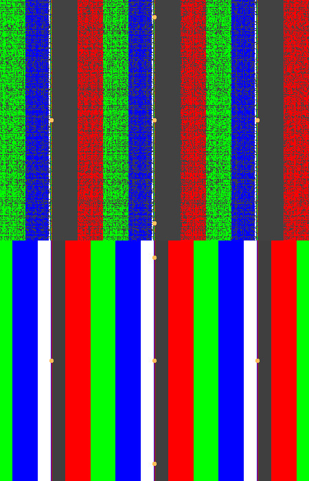

One thing you might try is, rather than use png, use gif.
https://en.wikipedia.org/wiki/GIF
It seems that gif exclusively used an indexed color palette (color look up
table).
Then you can simply open the gif in IrfanView, and use Image > Information, and
it will tell you how many unique color indices you have.
If you're going to do graphic / visual experiments, it might be worth assembling
a color_map such that your color entries are non-adjacent in the color wheel.
So, all of the even entries would be "monotonically" increasing from 0, and all
the odd entries would get shifted - say, by adding 127, and taking mod(N, 255)
to get the result that's "wrapped around to 0".
That way, you get maximum contrast between color indexes, and might be better
able to see doubled entries.
You'd need hard stops in your color map to prevent interpolation between
entries, and then you could simply render a smooth gradient across a wide image
format (1920 x 1080).
