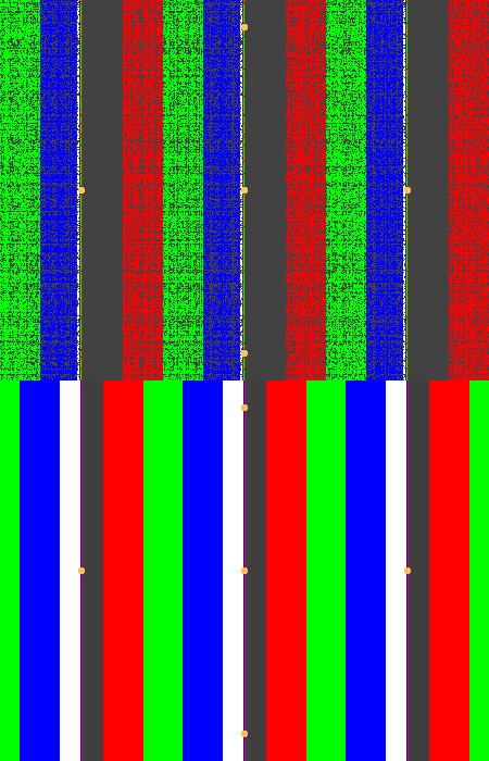

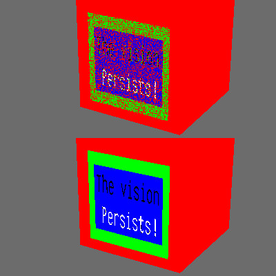

Find attached a sample scene for v3.8 beta 2 and an image where the top
portion shows noise from the bug and the bottom being the yuqk fork's
current output for the same set up with the fixes above applied.

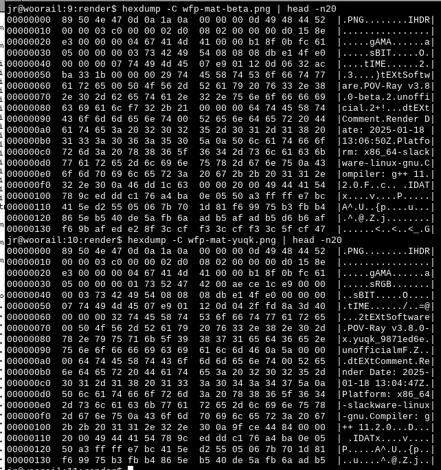

(*) - IIRC the default srgb set up with png files for recent official
v3.8 releases has an issue where the srgb block is not being written.
This was fixed in the yuqk fork.
I didn't know that. Although, for all of my usual .png renders in 3.8 beta 1,
Ive's IC app reports them as having the correct sRGB embedded gamma.

On the interpolation noise bug, I ran your scene with 'interpolation 3'
and I do see it with my v3.8 beta 2 compile (top). See attached image -
the current yuqk result on the bottom.

Download 'material_map_tester_kw_noise.jpg' (51 KB)
Preview of image 'material_map_tester_kw_noise.jpg'
From: jr
Subject: Re: material_map bug in v3.8 beta 2
Date: 19 Jan 2025 08:50:01
Message: <web.678d026f89dcc098f3dafc4d6cde94f1@news.povray.org>
hi,
William F Pokorny <ano### [at] anonymousorg> wrote:
> When you run v3.8 beta 1 without using 'file_gamma=1.0' on the command
> line (or as an ini setting), do you see the sRGB[**] text in the png file?
no, you're correct.  have attached output of a quick 'hexdump'[*], comparing
images rendered by beta.2 and the recent yuqk.
[*] easier to read :-).
[**] another "easy" one for the 1st commit ;-)
regards, jr.
Download 'betavyuqk.png' (40 KB)
Preview of image 'betavyuqk.png'
Yes, I see a bit of speckling even with interpolate 2, and far worse noise (like
your example) with interpolate 3 and 4.
