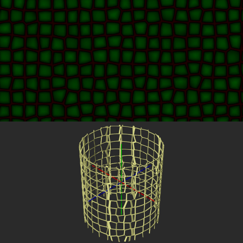

I didn't spend much time on it, but the top of the attached image shows
outlines as a pigment just slightly red (negative) by allowing raw value
returns after changing ip_form to: 'ip_form <-0.1,0.08,0> - the default
is <-1,1,0>.
The bottom of the image is an isosurface where a cylindrical shell is
intersected with a similar crackle pattern in space. No attempt wrap the
cylinder - just punching out a thin part of the crackle cell outlines.
The isosurface functions are:
// yuqk required
#declare Fn00 = function (x,y,z) {
     f_planar(f_cylinder(x,y,z,0.9),0.01,1)
#declare FnCrk = function {
     pattern {
         crackle
         ip_form <-0.1,0.097,0>
         ip_strength <0.25,0.25,0.25>
         ip_raw_return
         raw_wave
         translate <0,0,0.25>
         scale 1/5
#declare Fn01 = function (x,y,z) { max(Fn00(x,y,z),FnCrk(x,y,z)) }
Yes, The outline / cell-walls vary some due differences in gradients -
but more due how the slices catch the cell wall. For practical purposes,
expect an approach like this often OK for cell outlines.
Bill P.

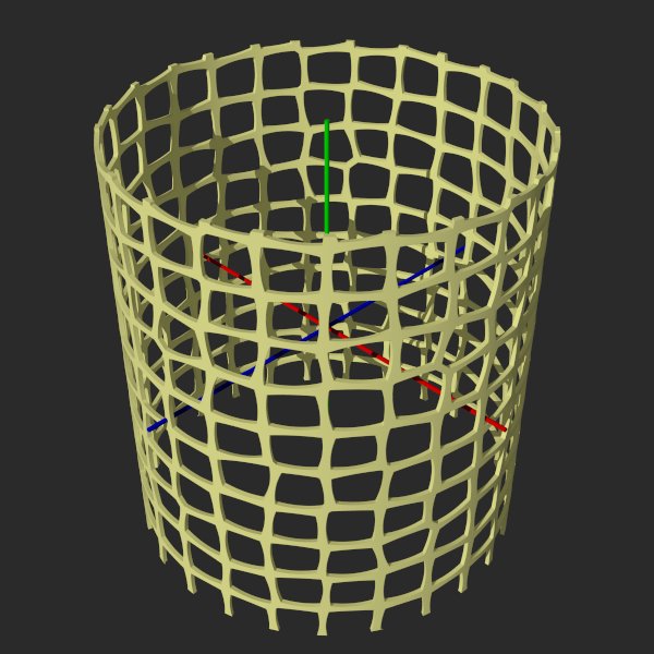

Got some coffee in me and gave the cylindrical warp a go. The crackle
function becomes:
     pattern {
         crackle
         ip_form <-0.1,0.080,0>
         ip_repeat <5,0,0>
         ip_raw_return
         raw_wave
         scale 1/5
         scale <1/5,1,1>
         warp { cylindrical }
(And I fattened up the cell walls for a better gradient)
Aside: I think there is a slight stretch in the wrap because the warp{}
mapping warps often seems to want radian measures - 'scale <1/tau,1,1>'
for best geometric mapping.
Anyhow. Image attached.
Bill P.

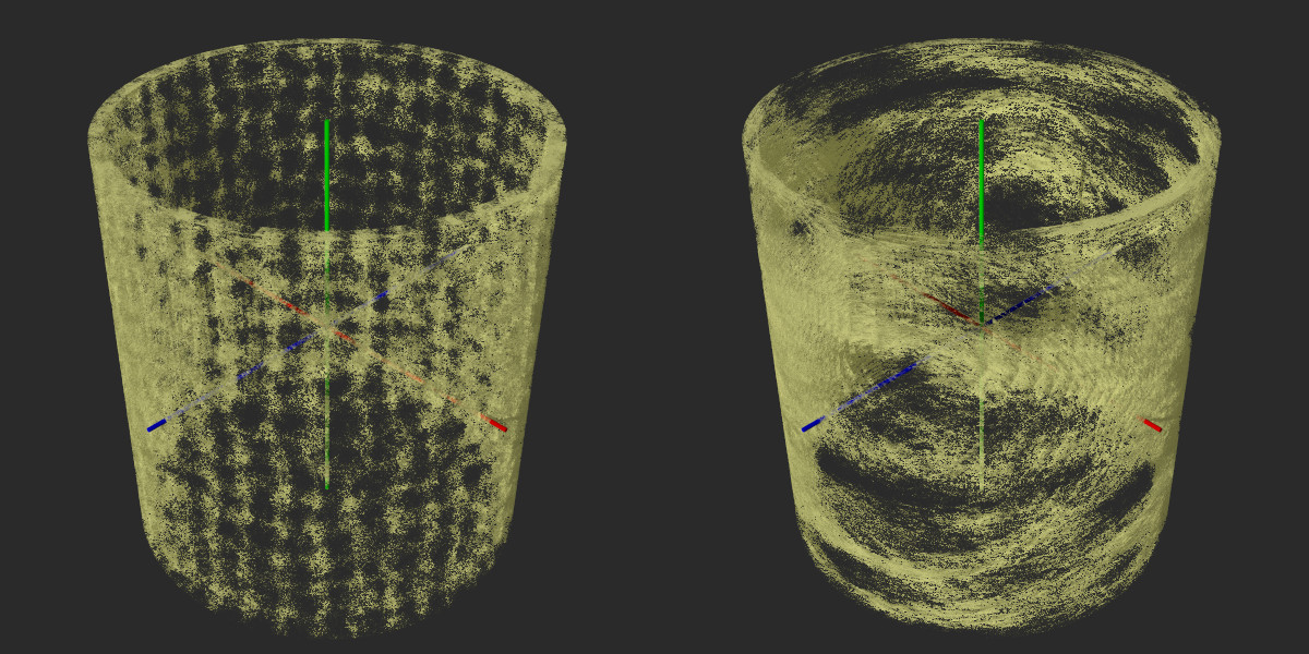

While playing, created attached images. The right one by accident...
Last part of the function { pattern {crackle ...} } used was:
         warp {
             it_amount <1/3,1/3,1/3>
             it_omega 0.87 it_lambda 4.7 it_scale 1/5
         scale <1/6,1,1>
         warp { spherical }    // Oops
Aiming again for shapes that are not really shapes in a usual way.
Suppose yesbird's recent gravity toy post in the same vein.
The isosurface gradient set low (1.3), accuracy really rough at 0.05,
but with isosurface jitter (jittering within accuracy range) on - and
aggressive AA (antialias_min_depth=2 +r4) sampling. yuqk only features
are involved.
Bill P.

>> On 11/17/24 06:51, William F Pokorny wrote:
>>> No attempt wrap the cylinder - just punching out a thin part of the
> Huh.  And what happens if you do the same sort of thing with something like the
> Stanford bunny?
If the aim is seeing the outlines rather than creating an isosurface
shape from them, the quick thing would be to create a pigment from the
crackle pattern set up to show outlines - the parts of the pattern not
outlines would be set transparent. Ignoring that we can define an inside
vector for a well formed / closed mesh, a mesh surface is already
infinitely thin for the purposes of sampling.
If you want to play with isosurfaces based upon a mesh, one of the
techniques to turn them into value fields would be the up front
approach. There are a couple SDL only ones. A method I posted in the mid
to late 2000s and one Sam B posted in the early 2010s. The yuqk fork has
hard_object{} and soft_object{} inbuilt features for turning shapes into
value fields / patterns.
The recent filling a shape with random noise approach might work for a
noisier result. There is too a way to pre-sample a shapes interior
saving the result as a df3 file which can then be used as a value
pattern suitable for an isosurface.
A straight intersection with a mesh having a clean inside region or any
object with an defined inside is an option too. The gradients will be
bad and the result, visually, less interesting as the outer layer of
cell outlines will hide everything to the interior.
Bill P.
