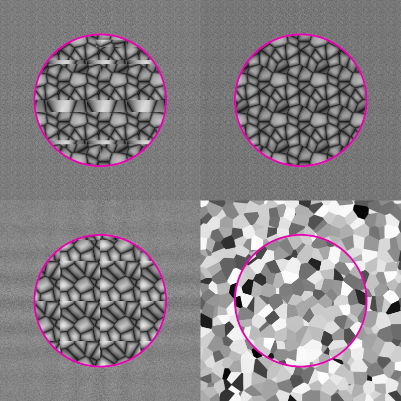

On 6/8/24 15:12, William F Pokorny wrote:
> I've been playing with 'facets' and 'crackle' of late. I've turned up a
> bug (or two) (*).
> Documenting now - partly so I can think through what I'm seeing as I write.
> The crackle pattern and facets perturbation maintain thread local
> storage so information can be cached in a thread safe way.
> The issue, I think, is that that storage is set up to work with one
> crackle and/or facets use per thread and no more.
> Once we run >1 of either in the same thread they share the thread local
> storage. This >1 usage per thread happens, for example, when we layer
> textures both based upon crackle
An update for those who might follow at some later time...
I think I've finished the re-write of the crackle pattern with a simpler
fixed size, per thread cache (for other than ip_solid on) which tracks
the pattern along with the center cube location. To be released in
yuqk(R16).
In testing the new code I discovered the 'repeat' feature of v3.8 beta 2
has a self cache collision issue at the origin in addition to the cache
collision issues of multiple crackle patterns within a thread.
For the attached images the scene set up is a large disc with a hole.
Within the hold there is a second smaller disc which doesn't quite fill
the hole. The rose color is the background seen through a gap. The outer
disc crackle pattern is scaled very small, but is otherwise the default
crackle.
The repeat, self, cache collision bug of v3.8 beta 2 is shown in the
upper left. I didn't chase a fix.
The image in the upper right is the version of yuqk I released in July
(R15) where, by hack, I disabled the crackle caching. The crackle
implementation is still what is in V3.8 beta 2. The repeat works as I
thin clipka intended!
In the lower left showing my development yuqk re-write, crackle repeat
feature result. Yes, its different than v3.8. I didn't like the
complexity and cost of the v3.8 implementation and went with something
simpler (I avoided the self cache repeat bug by chance...). With yuqk
(R16) the pattern flipping would be done with warp { repeat }(s).
The lower right is there just to fill out the 4x4! It shows the use of
a, new to yuqk, crackle ip_seed feature to change the inner disc's
ip_solid result. I added ip_seed to make it easier to get different
crackle looks on different shapes otherwise using the same crackle
pattern specification.
Bill P.
Aside 1: What is the repeated pattern on the outer disc seen in the v3.8
top row? It's a side effect of the more limited accuracy of the hashing
mechanism used to create the per cube point offsets in the v3.8 code. I
believe I changed things so this type of artifact is much less likely
with yuqk.
Aside 2 (*): Why is yuqk's lower left image a little brighter than
v3.8s? One of the aspects of the traditional POV-Ray crackle cube point
offsets is that they work from a starting corner. This produces a result
which, to my eye, creates too many pinched regions in the pattern's
result. With the yuqk re-write the offsets are done from the cube center
in a +-(0.0 to 0.49) way. Less pinching, more white area, brighter image...
(*) - This yuqk change unexpectedly created a sampling issue where, when
scaling the crackle pattern very small, the crackle's inner cube nature
becomes more quickly apparent when anti-aliasing is off. It's a kind of
harmonic of rays with the underlying, less pinched crackle pattern. It's
not an issue when AA is used.
Download 'v38b2_repeat_at_origin_bug.pov.txt' (1 KB) Download 'v38_repeat_at_origin_bug.png' (358 KB)
Preview of image 'v38_repeat_at_origin_bug.png'

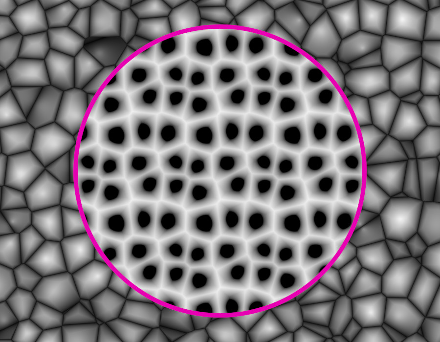

From: Bald Eagle
Subject: Re: v3.8+ crackle instability (facets?) with >1 uses per thread.
Date: 1 Nov 2024 09:40:00
Message: <web.6724d96618b34e67a2cb7a7025979125@news.povray.org>
William F Pokorny <ano### [at] anonymousorg> wrote:
> Took me a while, but I think I've gotten to what clipka was aiming for
> in his v3.8 crackle repeat feature. A <3,3,0> repeat is shown in the
> center of the attached image.
I would greatly appreciate some advice on how to properly accomplish this, as my
experiments in the past were fraught with unwanted artefacts:
https://news.povray.org/web.6394be0a7dc652cc1f9dae3025979125%40news.povray.org
I'm sure that one of your long "ramblings on" would be an insightful read, and
probably spur on other tangential projects - as they always do.
Hopefully we'll both have a few round-tuits at some point to compare notes.
Good work, and much appreciated!
- BW
From: William F Pokorny
Date: 1 Nov 2024 16:13:34
Message: <6725366e$1@news.povray.org>
Hi Bill.
Thanks.
Unsure how much my particular methods might help! How one might approach
repeatability depends on the environment, underlying metrics, forms, etc.
In my re-write of the crackle code I took advantage of newer hardware
and features of C++. For example, I push all the working coordinates
into a +x, +y +z space. Already the working grid internally (for the
cubes) was integer based as the origin for each offset point relative to
the evaluation point.
Much of the trouble I had with repeat (I suspect it's related to what's
wrong with the v3.8 repeat feature and caching too) was realizing I had
to do the cube calculations for offsets apart from the cached cube
coordinates. This something which might not even be doable with the
cache structure of the V3.8 beta 2 code - not thought about it too much
though. The yuqk caching is set up differently.
When I finally got my head on straight about that, the repeat code
became something which creates x,y,z unsigned integer coordinates
differently for the negative cube coordinates and positive cube
coordinates about the center evaluation cube - depending upon where in
the repeat range the evaluation point is on each axis.
In the POV-Ray implementation, a virtual environment of cubes containing
offset points is created around each cube in space where we find
ourselves evaluating 3D locations. For the repeat aspect, suppose I
created what amounts to another virtual working space on top of that one
in which to repeat.
Backing up, the POV-Ray set up of a virtual box of cubelets containing
the center cube with the evaluation point is driven by the 'form'
feature. It requires up to three closest point measures for downstream
metric calculations.
If for your crackle implementation, you only care about the closest
points - as is true for solid(*) results - the implementation can be
simpler.
(*) - In the yuqk re-write I treat the solid feature as something almost
completely apart from the crackle proper features.
Anyhow. The updated source code will be in the next yuqk release (R16).
Having it to review might help make sense of what I've written.
Bill P.
Aside: I'm reminded that years ago I experimented some with different
shape functions set at point locations as a way to to create crackle
pattern shapes - all in SDL - which was limiting. The traditional
crackle solid look you can create with cones. Can't find the post... Too
many ideas and not enough time. :-)
From: Bald Eagle
Date: 6 Nov 2024 10:55:00
Message: <web.672b906c18b34e674cc51b5c25979125@news.povray.org>
I guess I was mostly interested in if/how you were doing the modular arithmetic
to get seamless tiling, and assign pattern results to drive color_map values.
So - you've got a central cubelet surrounded by 26 other neighbor cubelets.
Is the central cubelet (off)set at <2, 2, 2>?
I suppose I will have to read through your code to better understand, and ask
better questions (or any at all).
Recalling some of your other posts - the pattern looks very "cubic" - rather
than a typical Voronoi pattern.
Also, have you thought about allowing user-defined distance metrics (Euclidean,
Manhattan, Minkowski, etc.) for generating the underlying pattern?
- BW
