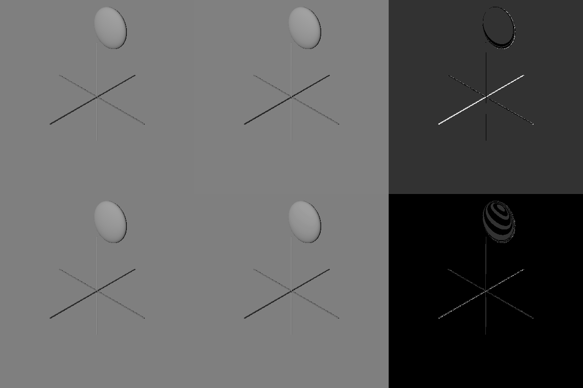

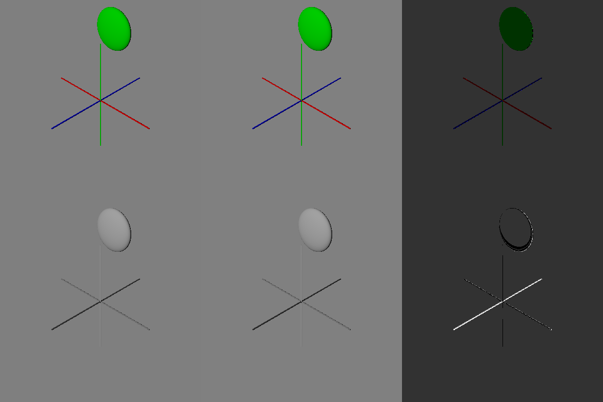

---  png gamma issue.
I've mentioned elsewhere POV-Ray makes a pretty good viewer for >8 bit
channel output files. While using POV-Ray as viewer it generates an
output file if not suppressed. On a whim - aka asking for trouble - I
decided to compare the original rendered output file with the viewer
output file - these should match. They don't.
First looking at the POV-Ray png default color output and immediate
input as an image_map in a viewer.
The short story is png output is hard coded to srgb unless overridden by
a File_Gamma setting somewhere. However, this hard coded output doesn't
trigger the generation of the correct srgb, encoding, information block
in the png file, but rather a power law 2.2 gamma block. When the
generated image is read it's done using a gamma correction which doesn't
match that used to generate the image.
What this means in practice is shown in the attached image top row where
the differences are multiplied by 50. The differences are small, but
certainly there.
In addition, looking at the output files generated by the following
commands and using iinfo to see the _gamma block encoding I see:
p380 render.pov +w400 +h400 +d -p +fn8 +ofn8
     oiio:ColorSpace: "GammaCorrected2.2"
     oiio:Gamma: 2.2
p380 render.pov +w400 +h400 +d -p +fn8 +ofn8_srgb File_Gamma=srgb
     oiio:ColorSpace: "sRGB"
p380 render.pov +w400 +h400 +d -p +fn8 +ofn8_1 File_Gamma=1.0
     oiio:ColorSpace: "linear"
     oiio:Gamma: 1
p380 render.pov +w400 +h400 +d -p +fn8 +ofn8_bt709 File_Gamma=bt709
     oiio:ColorSpace: "GammaCorrected1.9"
     oiio:Gamma: 1
Not worked out how to update the color png gamma code as yet. Or looked
into similar pgm/ppm differences. Suppose a good near term rule would be
to always specify the output and input gammas you want. When I do this
the render result and the viewer result output images match as I think
they should.
Aside: The bottom row of the attached image shows the greyscale
differences which include the default png gamma out issue above - plus
apparently more...
Bill P.

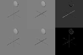

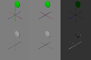

With respect to the current v3.8 not writing a png srgb gamma block
unless somewhere File_Gamma is set to 'srgb', the current v3.7 looks to
be OK. If the gamma correction used was srgb, explictly or not, the srgb
block is always written.
Somewhere during the v3.71 / v3.8 work something changed - but I cannot
pick up the cause just reading the code. And! this time I'm not going to
spend 3-4 hours compiling different historical commits to try which
commit broke things.
The fix in the png.cpp file is to change:
#if defined(PNG_WRITE_sRGB_SUPPORTED)
     if (options.encodingGamma &&
             typeid(*options.encodingGamma) == typeid(SRGBGammaCurve))
         png_set_sRGB(png_ptr, info_ptr, PNG_sRGB_INTENT_PERCEPTUAL);
#endif // PNG_WRITE_gAMA_SUPPORTED
to read:
     if ((!options.encodingGamma) ||
          typeid(*options.encodingGamma) == typeid(SRGBGammaCurve)))
With this update above the color render and viewer v3.8 outputs match
whether File_Gamma explicitly set to srgb or not.
The grey scale too is better as shown in the attached image. The top row
less the fix above and the bottom row with the fix. There is still
something off related to non-grey defined colors in the render.pov
result leading to different between render and viewer by as much as
11/255(1). I don't understand what is happening there as yet...
(1) - Prior to the srgb gamma chunk fix the max color differences where
9/255 at very low luminance.
With the previously posted grey output pgm/ppm fix, both the color and
greyscale ppm outputs match so long as 'gamma=bt709' is used when
defining the image_map (reading the POV-Ray created image file). The
netpbm format doesn't encode the gamma on write - so you have no choice
but to be explicit on the read if you want to be sure you match.
