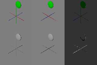

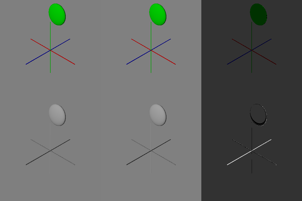

First, looking at the POV-Ray png default color output and immediate
input as an image_map in a viewer.
The short story is png output is hard coded to srgb unless overridden by
a File_Gamma setting somewhere. However, this hard coded output doesn't
trigger the generation of the correct srgb, encoding-information block
in the png file, but rather a power law 2.2 gamma block.
What this means in practice is shown in the attached image top row where
the differences are multiplied by 50. The differences are mostly small,
but certainly there.
In addition, looking at the output files generated by the following
commands and using iinfo to see the _gamma block encoding I see:
p380 render.pov +w400 +h400 +d -p +fn8 +ofn8
     oiio:ColorSpace: "GammaCorrected2.2"
     oiio:Gamma: 2.2
p380 render.pov +w400 +h400 +d -p +fn8 +ofn8_srgb File_Gamma=srgb
     oiio:ColorSpace: "sRGB"
p380 render.pov +w400 +h400 +d -p +fn8 +ofn8_1 File_Gamma=1.0
     oiio:ColorSpace: "linear"
     oiio:Gamma: 1
p380 render.pov +w400 +h400 +d -p +fn8 +ofn8_bt709 File_Gamma=bt709
     oiio:ColorSpace: "GammaCorrected1.9"
     oiio:Gamma: 1.9
Not worked out how to update the color png gamma code as yet. Or looked
into similar pgm/ppm differences. Suppose a good near term rule would be
to always specify the output and input gamma you want. When I do this,
the render result and the viewer result images match - as they should.
Aside: The bottom row of the attached image shows the greyscale
differences which include the default png gamma out immediate issue
above - plus apparently more with greyscale...
Bill P.
