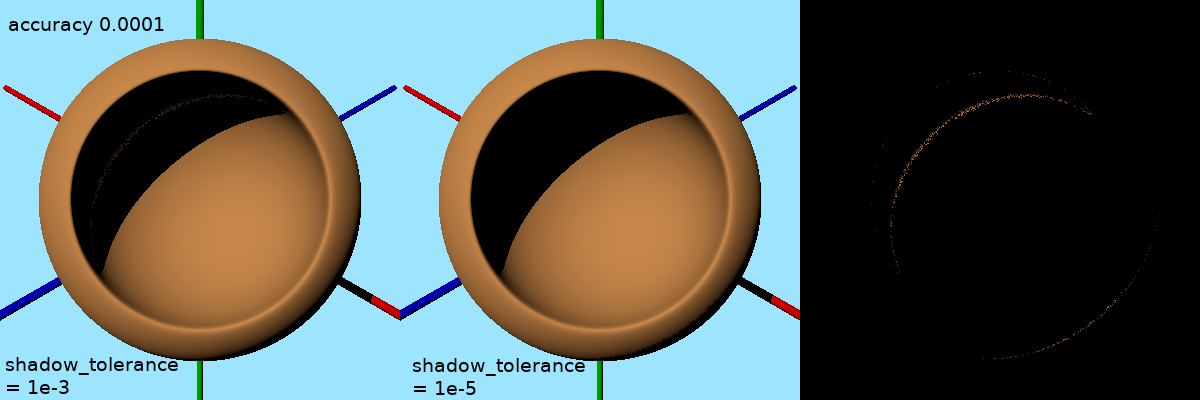

Attached is an isosurface scene using the new to povr f_mult1to8pairs to
do a difference between two spheres. The smaller cutting into the larger
while using a small value burn off to get rounded edges.
Straight up with a larger accuracy setting you get rings artefacts (not
shown). The traditional way to try and solve this is to crank down on
the gradient and the accuracy. Taking the accuracy to 0.0001 in this
scene and we suddenly get a bright arc where there should be shadow.
What is happening is the inside curvature is 'inconvenient' for the
shadow ray tracing given the usual 1e-3 shadow tolerance.
In the middle image we use: global_settings { shadow_tolerance 1e-5 }
and, presto, we get the correct result. The difference image on the
right uses a multiplier of 3x to make the differences a little easier to
see.
