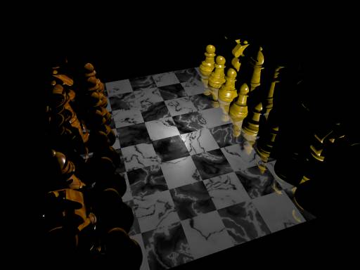

The code for the image was written in POV-Ray 3.1g and the image traced
as
expected. Now, with POV-Ray 3.5 Beta 10, running on a 1.4 GHZ Athlon
with
512 MB Ram on Windows 98, it does not.
I have not found any similiar bug in the bug-list, and I think this is a
new one.
I'll see if the bug also takes place in the Beta 9, to see if it has to
do with some
changes.
The image at the end shows the problem: the lighting is messed up,
though the light-
source is positioned just above the center of the chessboard. Figurines
are placed
with macros, as is the board.

The bug is as follows:
After including the files with the macros, and then placing them, the
shadows and illumination
aren't properly. The lightsource (the only one, I checked several times
using "search" for "light")
is positioned right in the middle of the chessboard, a few centimeters
up.
As you can see in the attached image, some objects are illuminated from
below, the sides or
whereever!
I don't know if this has to do with the macros (though they don't look
wrong or too complicated
to be misunderstood that easily), or the light-sources, or something of
both.

I confirm that there is some sort of a problem with the lighting.
I've stripped down the scene to about the minimum that reproduces the
problem, and it turns out it can be reproduced without macros. The key
factor is probably the two rotated turbulence warps in the normal.
Change the amount of rotation in either of the "rotate"s and the
lighting changes.
Remove the second warp turbulence and the problem goes away.
Increase the height of the light_source and the effect is reduced.
The problem does not occur in POV 3.1g.
