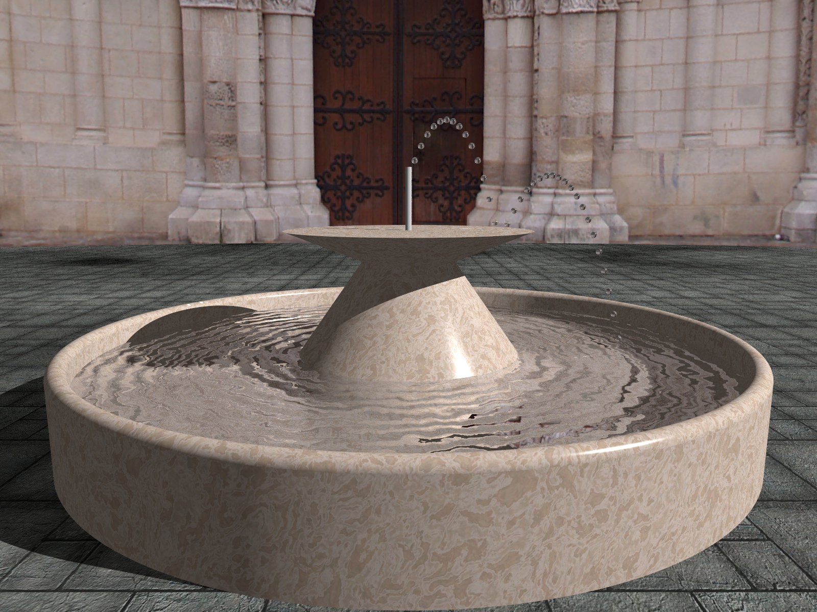

Him I am trying to replicate this water droplets all around the tap -see the
image attached-, so maybe a series of droplets every 12 or 24 degrees around z
axis. How should I do that? I know it is a beginner trick, but I am trying
different #while sentences and it doesn't seem to work out. Could somebody help
me? Here is the code I am using to achieve the droplets look like a trajectory.
Thanks in advance for any help,
// FUENTE SUPERIOR
#declare posX = 0.02;
#declare posY = 0.82;
#declare dy = 0.055;
#declare posZ=0;
#declare posZ= <0,0,posZ+12>;
    #while (posX < 0.3)
    sphere {
    <posX,posY,0>, 0.01
    material { agua }  }
    #declare dy = dy - 0.01;
    #declare posX = posX + 0.02;
    #declare posY = (posY + dy);
    #end
Download 'fuenteee.png' (2682 KB)
Preview of image 'fuenteee.png'

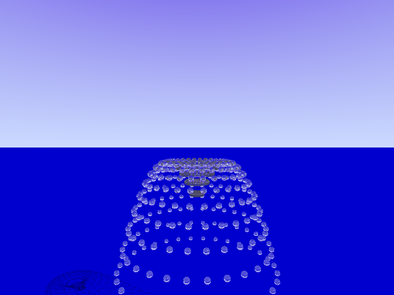

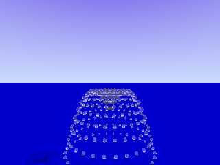

You want to work with your object at the origin (<0,0,0>), manipulate
it, then translate it to it's final position. I think you are assuming
that the fountain stem is at <0,0,0>. What if you move it?  SO here,
what you really want to do is define a max radius for your circle sweep.
#local maxRad = 0.3;
#declare FountainSpray=
union {
     #local dy = 0.055;
     #local YY = 0.82;
     #for (MR, 0.02, maxRad, 0.02)
         #for (KK, 0, 359, 12)
             sphere {
                 MR*x, 0.01
                 rotate KK*y
                 translate YY*y
         #end
         #local dy = dy-0.01;
         #local YY = (YY+dy);
     #end
//    material {agua}
     material{ texture { Glass3  } // end of texture
               interior{ I_Glass } // end of interior
             } // end of material -------------------
#declare FountainPos = <0,0,0>;
object {FountainSpray translate FountainPos}
Download 'test.png' (93 KB)
