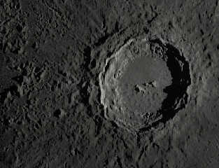

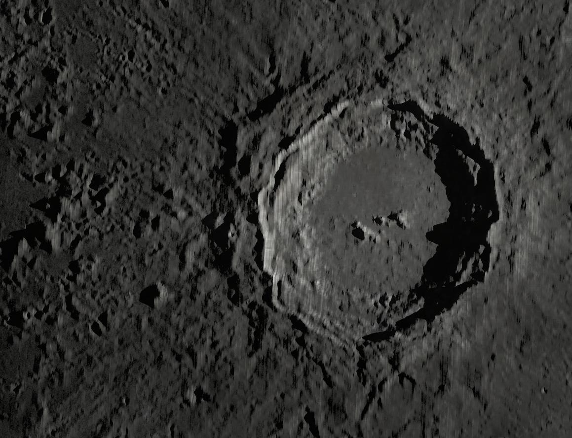

I'm currently trying my hand at spherical heightfields, but I'm running into
strange problems.
I put a height map (DEM) of the moon around a sphere, based on these forum
posts:
https://news.povray.org/povray.binaries.images/thread/%3C38a2dc5b%40news.povray.org%3E
https://news.povray.org/povray.text.scene-files/thread/%3C38A037EB.504C1A6%40inapg.inra.fr%3E/?ttop=444549&toff=750
Everything looks good in the global view, but when I zoom in closer, radial
errors appear at the day-night boundary.
A higher resolution of the DEM does not change anything, and it works fine when
using bump_map.
But the larger the sphere (contained_by), the finer the disturbances?!
Unfortunately, I have no idea what the functions in the script do.
This one in particular puzzles me:
x*x+y*y+z*z + 0.1 - hftext(x,y,z).y * 0.03
Can someone help me with that?
Is there a reasonable tutorial that explains the working of user-defined
functions well?
Or does anyone find the bug in the script that causes the glitches?
doesnt helps me to understand the stuff:
https://www.povray.org/documentation/view/3.6.2/231/
My code used, greatly simplified:
 #declare hftext = function {
  pigment {
   image_map {
    png "moon_dem.png"
    map_type 1
 #local mResult = isosurface {
  function {
   x*x+y*y+z*z + 0.1 -
  contained_by {
   sphere {0,1}
  max_gradient 10
  threshold 0.95
  //threshold 2
  texture {
    pigment {
     color rgb <0.3, 0.3, 0.3>

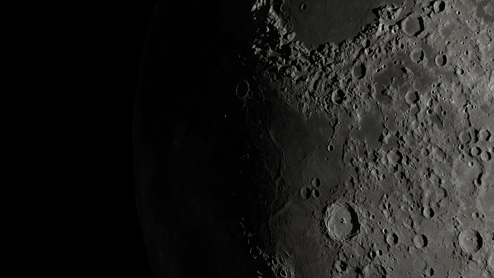

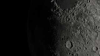

From: Maetes
Subject: Re: Spherical Heightfields
Date: 26 Feb 2025 02:05:00
Message: <web.67bebbab6a47dfbb40074f6e30225ff5@news.povray.org>
Hmmm... maybe I just see light at the end of a very long tunnel.
I picked out the most important lines from Lunex, cut them down to the bare
minimum, and now it seems to work.
One suspicion is: Size does matter.
So far I have used radii between 1 and 10 for the sphere, Lunex uses > 1000.
I'll continue to play around with it, it's far from perfect, but it looks better
than before, see picture.
Thanks again for the tips.
Martin

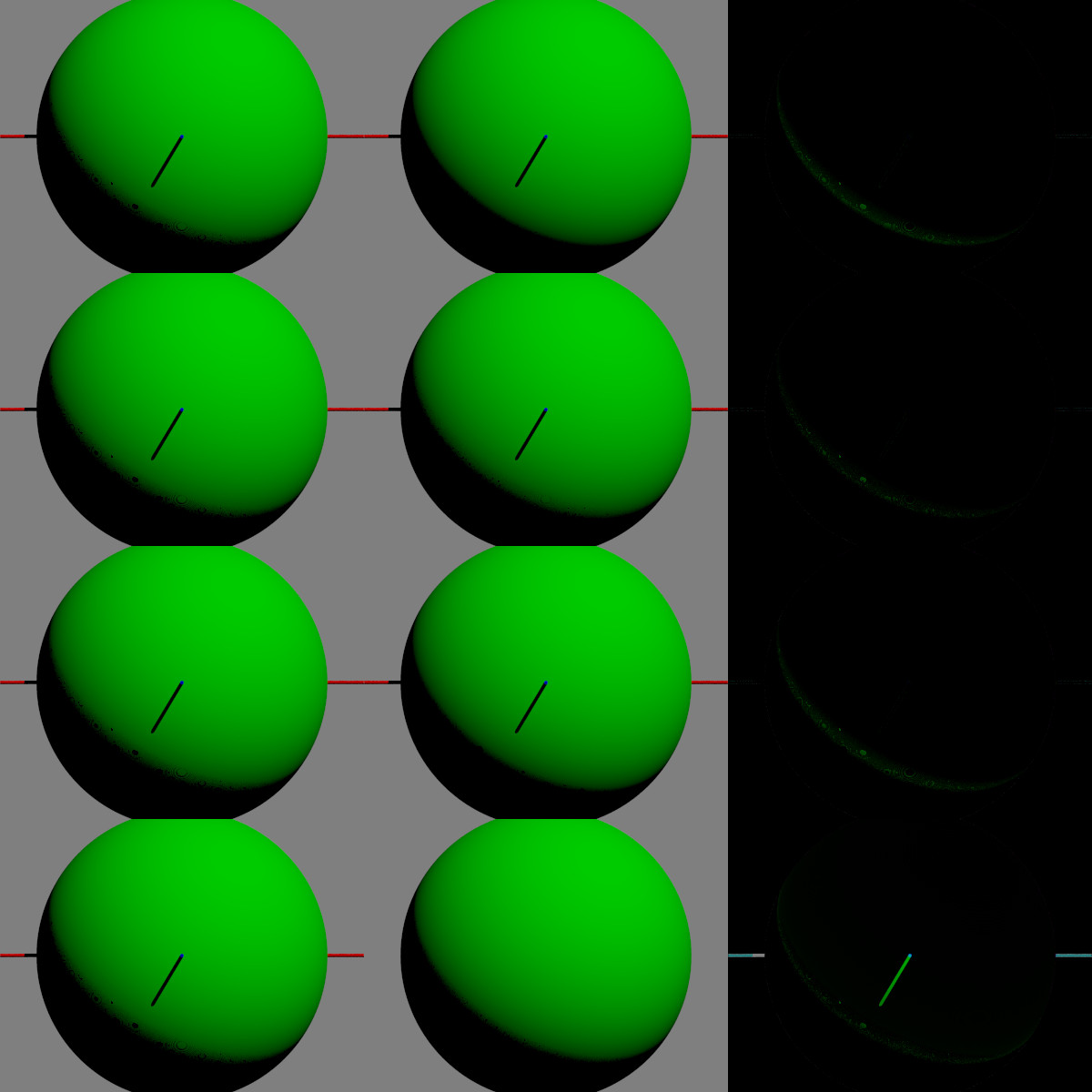

From: William F Pokorny
Date: 1 Mar 2025 09:35:01
Message: <67c31b15@news.povray.org>
Your "Size does matter" comment got me thinking about adding a short
article and image to my yuqk documentation. Initial versions of both
attached; Perhaps of some help.
Bill P.

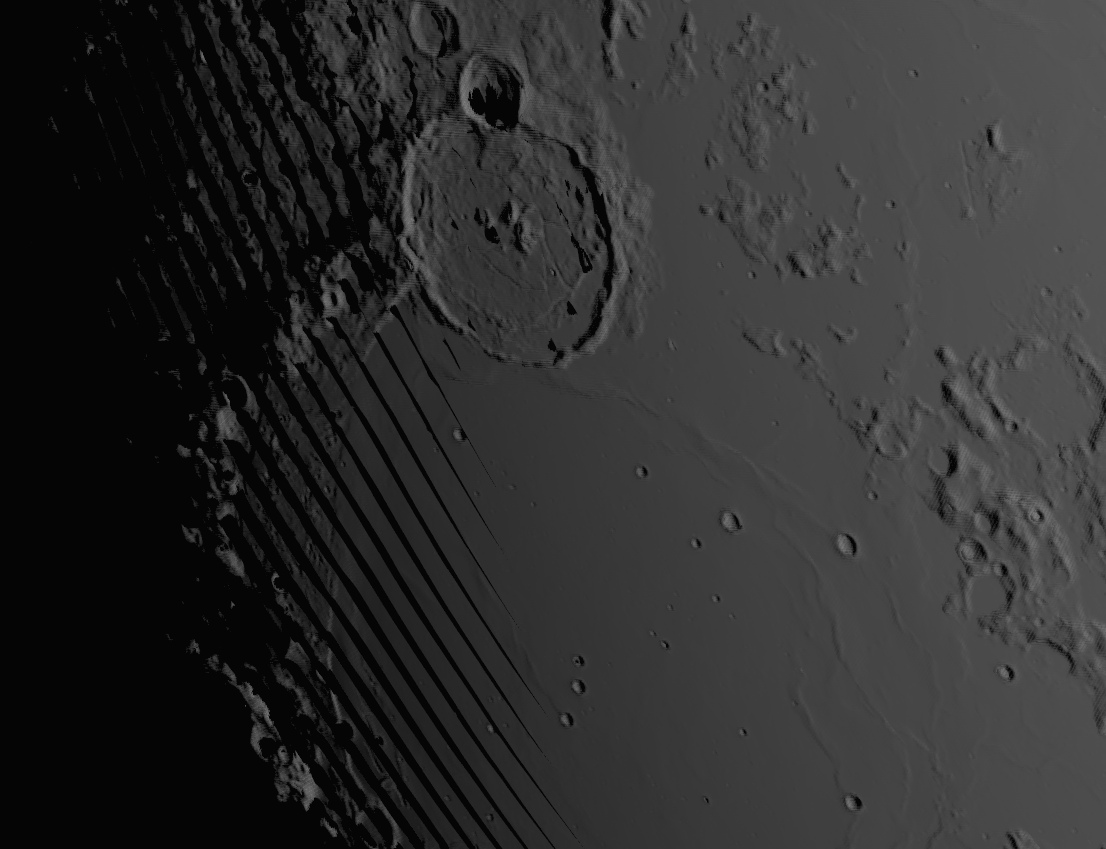

From: Maetes
Date: 10 Mar 2025 22:40:00
Message: <web.67cfa1516a47dfbb91d9a21130225ff5@news.povray.org>
Hi William,
thanks for your textfile.
I had to struggle with artifacts like in the left column of your picture, they
are now gone.
Looks good so far, only at high magnifications I have to deal with vertical
lines, see picture.
I want to work on it again in the next few days and see if I can improve it.
Will try the hints in your article, especially change accuracy settings.
