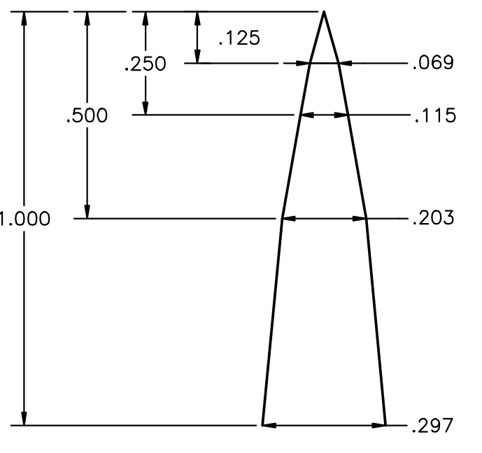

I've got a diagram of where measured points should be along a CURVE that
describes the profile of a solid edge.
You can see from the diagram, that a linear connection of the points would give
me a shape where the measured dimension points would be at the vertices of
concave angles, and so the appropriately shaped object {} would touch the lines
rather than the dimension points.
What I'd like to do is use those dimension points as the endpoints of Bezier
splines, such that the resulting curve was smooth and continuous.

From: ingo
Subject: Re: Smooth, continuous Bezier splines (again)
Date: 28 Jan 2025 01:25:00
Message: <web.6798782996675d9f17bac71e8ffb8ce3@news.povray.org>
The bisect of the angles in the current lines are the normals to the handles in
that point. The handles should be equally long to get C1/G1 (?) continuity.
I think, without testing,
ingo

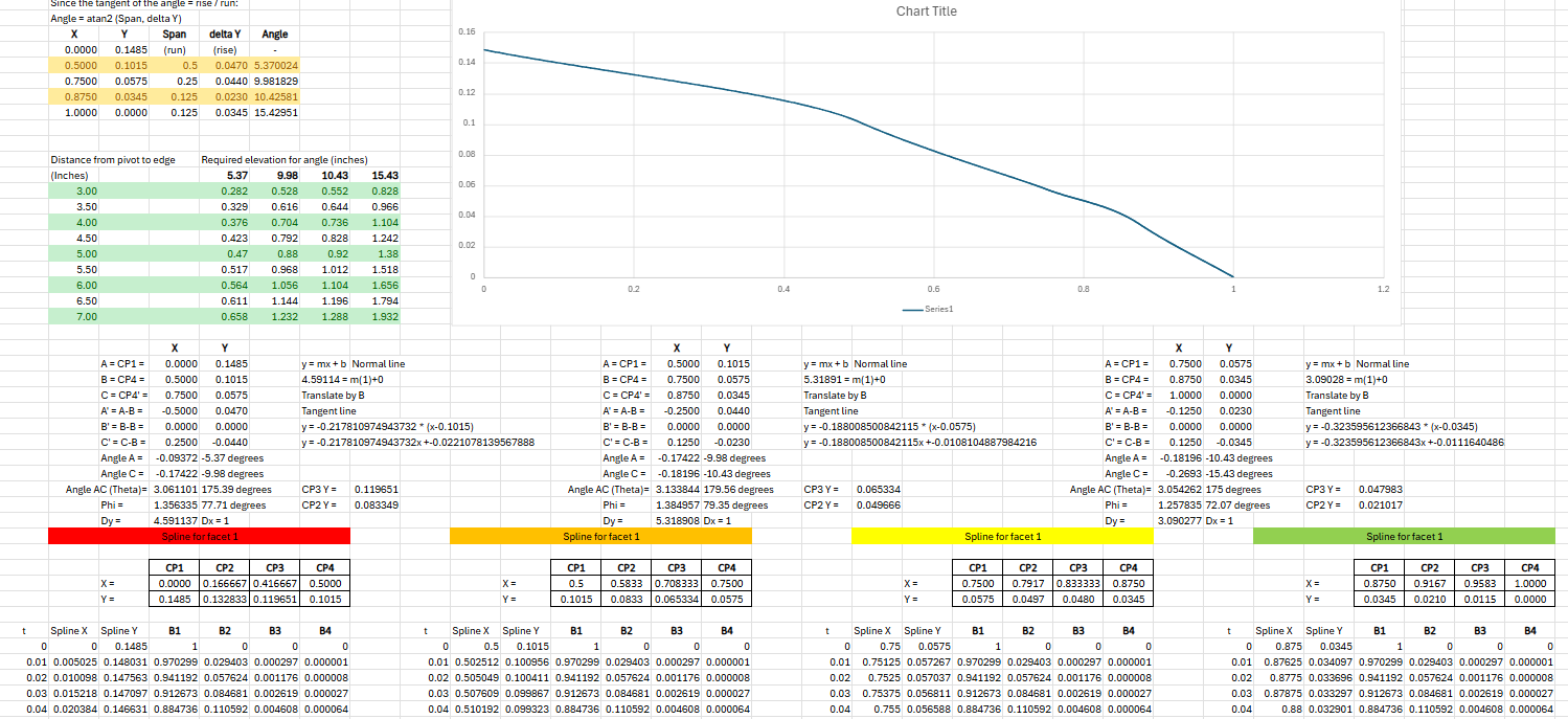

Yes, excellent idea.
I was futzing around with something along those lines yesterday, but I'm stuck
doing it in M$ Office 365 Copilot web version - which is painful enough - but I
was working on it piecemeal, so I only had so much time in one stretch to focus.
At present, I take 3 control points, bisect the angle, find the perpendicular
slope (negative reciprocal), use the equation of that line to sub in 1/3 of the
shorter vector, and solve for the control point y-values on either side of the
endpoint.

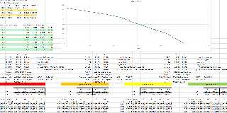

I have the Bezier splines charted using the Bernstein polynomials, and
concatenated together using "helper cells".
There are still "bumps", so I think I still need to somehow account for the
varying curvature along the splines.
Download 'screenshot 2025-01-28 133147.png' (129 KB)
Preview of image 'screenshot 2025-01-28 133147.png'
