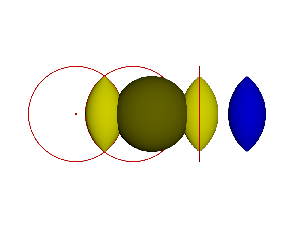

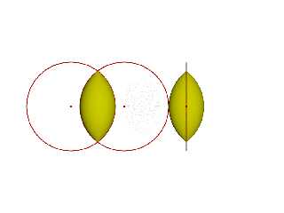

I was interested in using a lemon, or the inner surface of a spindle torus, or
the surface of revolution of a vesica piscis - whichever terminology you prefer
- to compare to a surface.
There is precious little information that I can find describing the lemon, and I
wanted a parameterized object.
The documentation doesn't have a diagram of how the lemon {} available in
version 3.8 is constructed (like it does for the ovus {} ), and the explanation
took me longer than it should have to clearly understand.
https://wiki.povray.org/content/Reference:Lemon
https://wiki.povray.org/content/Reference:Ovus
Presently, I have two problems. And one other issue.

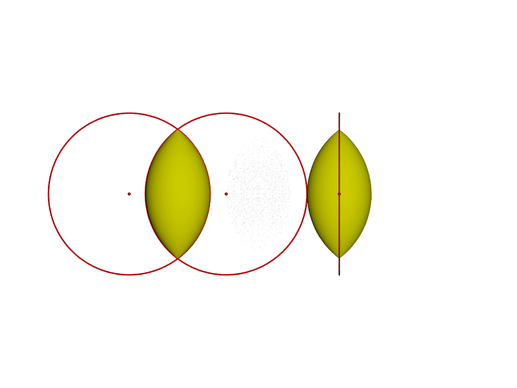

First, when I try to render the lemon {} object with the current parameters, I
only get a very faint speckling rather than a well-formed surface. (I have
rendered several successful test lemons in 3.8)
You can just see it in the render.  This makes me sad, as I know Jerome Grimbert
did a lot of work on this shape.
Second, after I finally worked out how to isolate the inner surface of a
standard torus using an isosurface, I found that I needed to add a Fudgefactor
to the minor radius in order to remove a lot of artefactual noise.  I found the
0.2 magnitude of the FudgeFactor to be disturbingly large.
(Maybe I would have better luck with a polynomial object.)
The other issue is that the isosurface seems to have the interior_texture on the
outside, and the texture on the inside.
Anyone have any ideas?

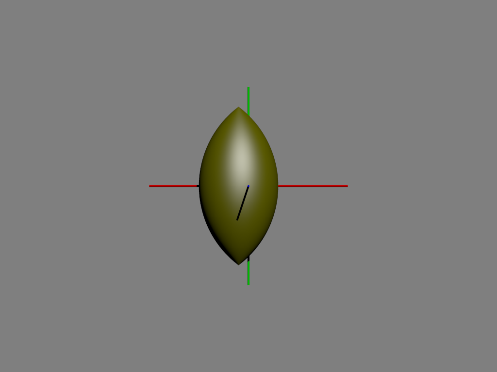

From: Bald Eagle
Subject: Re: lemon {} revisited
Date: 11 Mar 2023 16:20:00
Message: <web.640cef821e421ea21f9dae3025979125@news.povray.org>
And wouldn't you know it, subtracting that exact same FudgeFactor from the
radius in the lemon {} makes it show up, but as a sphere, not the shape that I'm
shooting for.
Puzzling.

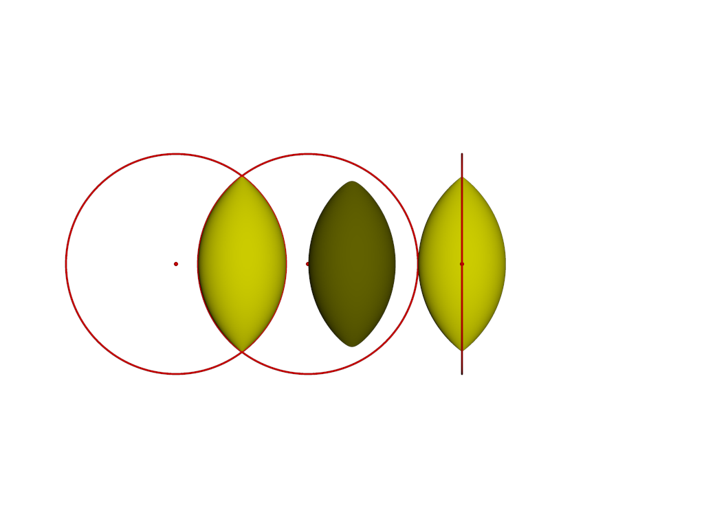

From: William F Pokorny
Date: 11 Mar 2023 23:47:49
Message: <640d5975$1@news.povray.org>
I'm in the middle of another code tangle, but...
After the lemon was added and we started to bang on it, a few numerical
issues turned up. I think most of this was discussed for a time on the
developer mailing list. No idea what is fixed. What might github have...
Looks like https://github.com/POV-Ray/povray/pull/358 has a little on
the lemon if you scroll down through the comments. Well, I suppose not
would help you near term of that work in any case.
A reminder the f_torus inbuilt function implements a couple of the
spindle modes though it is not directly documented anywhere that I know
about. See post to povray.binaries.images
Subject: Some v38 torus vs f_torus() information.
Date: 30 Apr 2020 08:32:29
https://news.povray.org/povray.binaries.images/thread/%3C5eaac55d%241%40news.povray.org%3E/
Message: <5eaac55d$1@news.povray.org>
Running your scene with my current development povr code, and without
sturm(a), I get the attached a result.
Bill P.
(a) - With sturm on I get a tiny nub on the ends bringing the height to
to about where the left and right shapes are. Without it it 'looks' like
the shape is a little more rounded at the ends than your equivalents.
Might be there is still some other numerical stuff going on... It's not
the easiest shape for the solvers.
Download 'be.png' (53 KB)
Preview of image 'be.png'
Date: 12 Mar 2023 00:17:55
Message: <640d6083$1@news.povray.org>

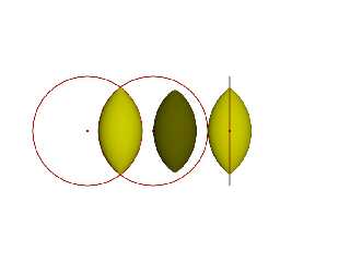

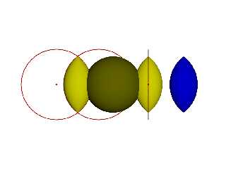

On 3/11/23 23:47, William F Pokorny wrote:
> It's not the easiest shape for the solvers.
Ah, and you are using an orthographic camera. This often the worst case
ray set up for the solvers. Other shapes like the sphere_sweep have
similar issues with the orthographic camera. Your' also positioning well
away it looks too.
If I step an ortho camera back just -2 in z and code as the lemon:
#declare r = 1;
#declare R = 0.6;
#declare Y = sqrt ( r*r - R*R );
lemon {
   <0, -Y, 0>, 0, <0, Y, 0>, 0, r
   texture {pigment {rgb <0.2, 0.2,0>} finish {specular 0.4}}
   sturm
   translate <-.1,0,-.1>
I get the attached image.
The ray length matters in that the longer it travels the more the
accuracy of the ray->surface equation degrades in accuracy. The equation
has to represent all those useless potential landing steps on the way to
the shapes surface and this burns up the floating point accuracy.
That bit was my painful discovery discussed in the previously referenced
github issue. I have a solution for best possible floating point
hardware accuracy, but the implementation is not trivial...
Bill P.
Download 'behmm.png' (29 KB)
Preview of image 'behmm.png'

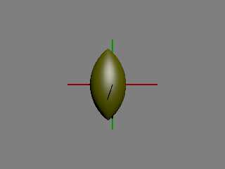

From: Bald Eagle
Date: 12 Mar 2023 08:50:00
Message: <web.640dc9811e421ea21f9dae3025979125@news.povray.org>
William F Pokorny <ano### [at] anonymousorg> wrote:
Haha!  Your previous post jogged something in my memory that provides a truly
trivial solution.
Yes.  Any time you see me doing graphs and drafting layout lines, there's a 99%
chance it's an orthographic camera.
> Right.  I hammer through so many exploratory idea and experiments that my default is
a copy-paste from one of the 20
last-working-scene tabs that  I have open in the editor.
> Your' also positioning well away it looks too.
IIRC, it was the single-image photogrammetry where I had an issue with all my
stuff disappearing because it hadn't damned on me how LARGE the objects were,
and therefore how far back they extended (past the camera plane).   So yeah,
it's WAAAAAY back.   I'll try to keep those under-the-hood issues about the
solver and the camera distance in mind.
Perhaps an interesting thing to have available in povr would be a "global
bounding box" for the scene in the render statistics.  It could help clue scene
authors in to overlooked distance issues and maybe help track down spuriously
placed objects, as well as resolve other weird issues.
Still not sure what the crud on my isosurface is that gets removed with the
FudgeFactor.   I'll make a quick switch to the perspective camera and see if it
goes away.
On to the trivial solution.
Spindle torus, did you say?
"The merge and intersection spindle modes have long existed with the f_torus,
but via value arguments."
Well, they've long existed for the regular torus primitive too.
Which I had discovered, and therefore "knew", but forgot.
http://news.povray.org/povray.binaries.misc/message/%3C604613ed%241%40news.povray.org%3E/#%3C604613ed%241%40news.povray
.org%3E
https://wiki.povray.org/content/Reference:Torus
and so, adding
torus {R, r intersection texture {pigment {rgb z} finish {specular 0.4}}
translate x*2*r}
gives me just what I was looking for.
"Oh, POV-Ray developers, you understand everything!"  :)
Download 'lemon.png' (65 KB)
Preview of image 'lemon.png'
The speckling was even worse for me.
By changing the camera to 'perspective' and with location <0,0,-.7>, I see the
nice lemon shape. Also, I don't see any difference re: sturm vs. no sturm.
> on the outside, and the texture on the inside.
As an experiment, I negated your spindle function...
      #declare Iso =
      isosurface {
       function {-Spindle (x, y, z)}...
and the interior/exterior textures look correct now. A clue to something?
I did the same but needed to remove the fudge factor to transition from the
sphere to the lemon.
My isosurface still need the fudge factor, else I still have the cylinder of
crud.
It's just the sign.  I was just wondering if the native implementation of the
torus was "wrong", since I recall the uv-mapping being off compared to most
other shapes.
