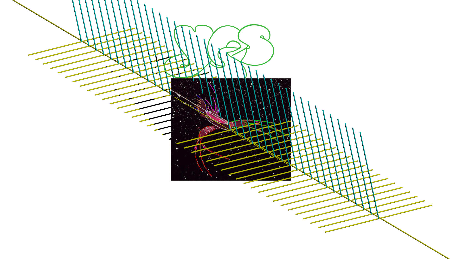

Making the line perpendicular in screen space.  Then when the z-buffer line gets
rotated it remains "in place"/in-line with where it already is, just with +/-
z-components in the vectors of the now-rotated endpoints.
> > If I rotate a copy of the line segment around this axis, it should visually
> > remain in line with the original line segment, but the ends would appear to
> > contract.
> I can sort of 'see' this...depending on whether or not I understand the initial
> stuff.
Image of work so far attached.   It's halfway there, though I'm guessing at
magic rotation angle numbers and just flying by the seat of my pants through
intuition.
> intuition.
Haaa, what I see !
You started 3D reconstruction of Yes-related staff with photogrammetry ...
Very interesting, but it seams to me implementation will be not easy, as we have
only one-view here.
In any case, please tell me if I can help you with some Matlab's methods, you
know, I have one )
