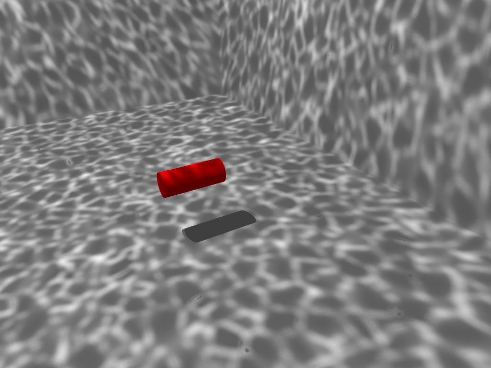

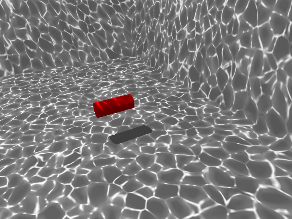

From: Juergen
Subject: Re: How to create realistic caustics?
Date: 11 Mar 2022 17:35:00
Message: <web.622bcd6ba728bcefa6f2d031df9b2273@news.povray.org>
Hi,
I have been looking into the topic of caustics once again. Starting from a scene
that I found on the Internet, I have adapted for a need and have come after some
trying also to a useful result (1.Appendix "Photons..."). However, setting the
photon parameters is quite difficult until you get a good result. Especially you
have to override the number of photons (in my case with "spacing").
But still the problem with the needed computing time remains. The example in the
attachment takes about 100sec to calculate, my later scene, where I want to use
this, *over 10 hours*, where 99% goes for the photon calculation and the actual
render takes about 5 min. (And saving the photons is not possible, because this
is to be used later in an animation).
Therefore I have tried other variants:
1. cautics from Povray itself: here I got a "nice" result
2. a superimposed texture: you can forget it, it looks like crap in all
attempts.
3. simulation via a second, covered bright light source. A light source is
simply surrounded by a partially transparent sphere to achieve the corresponding
effects. Hereby I achieved the best result so far (attachment "lightsource...").
The problem here is that first the complete scene is covered with the texture.
If there are also areas in the picture that are outside the water, the light
source must be blocked additionally, so that these areas are not illuminated.
Furthermore, the cast shadows are just as sharp as with any other light source,
but I think you can live with that.
Translated with www.DeepL.com/Translator (free version)
http://www.cfjh.de/gal/div/pov/lightsource.jpg
http://www.cfjh.de/gal/div/pov/lightsource.zip
http://www.cfjh.de/gal/div/pov/photons_0.1.jpg
http://www.cfjh.de/gal/div/pov/photons.zip

From: m@b
Date: 11 Mar 2022 20:21:18
Message: <622bf58e$1@news.povray.org>
Light Group Might be the solution.
Light groups make it possible to create a union of light sources and
objects, where the objects in the group are illuminated by the lights in
the group or, if so desired, by the global light sources as well.
m@
From: Alain Martel
Date: 12 Mar 2022 10:50:23
Message: <622cc13f$1@news.povray.org>
>> texture.
> m@
Another solution could be the use of projected_thru attribute for a light.
It create an «aperture» thru witch the light is projected. A bit like an
anti-shadow. Here, you just need a thin, untextured, box set just at the
water level.
light_group don't work with photons.
projected_thru DO work with photons.

To get a 'smoother' (blurred) effect, try replacing your 'sonne' light_source
with this area_light; the scene will take a somewhat longer time to render, but
certainly not as slowly as using photons.
//sonne
light_source {
  <0,0,0>
  color rgb 5
  area_light
  <.14, 0, 0> <0, 0, .14> // adjust values larger or smaller
  5, 5
  adaptive 0
  jitter
  circular
  orient
  translate <-50, 200, 0>
Download 'caustics_sphere_with_area_light.jpg' (63 KB)
Preview of image 'caustics_sphere_with_area_light.jpg'
From: Kenneth
Date: 14 Mar 2022 13:20:00
Message: <web.622f7910a728bcef4cef624e6e066e29@news.povray.org>
> with this area_light...
Or, use BOTH of the lights, in the same location-- and perhaps with different
colors for each...
// Sonne
light_source {
  <-50,200, 0>
  color 3*<1,1,.5>
light_source {
  <0,0,0>
  color rgb 6*<0,1,.92>
  area_light
  <.2, 0, 0> <0, 0, .2>
  5, 5
  adaptive 0
  jitter
  circular
  orient
Download 'caustics_sphere_with_two_lights.jpg' (104 KB)
Preview of image 'caustics_sphere_with_two_lights.jpg'
