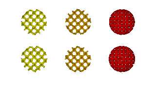

Am 08.12.2024 um 17:25 schrieb kurtz le pirate:
> I also have problems with PrettyBall_1. 3 isosurfaces. Two are ok. The
> third really doesn't match. Yet the code is/looks ok.
Indeed, this is actually a very strange difference between POV and
MathMod. In the top row are the three objects as isosurfaces in POV,
below are the objects exported from MathMod with the same formulae. The
second and third objects match quite well, while the first one is
completely different. I cannot judge whether the error is in POV or in
MathMod.
If you compare the two objects on the right and in the centre in the
bottom row (MathMod), you may get the impression that the one on the
right could be created from the middle one as a point reflection at the
origin (scale <-1,-1,-1>) and in fact both are largely congruent after
this operation. You will get the correct result with POV if you create
the first object from the centre one with the mentioned scaling or
change the definition of GyroidLatice_1 as follows:
#declare GyroidLatice_1 = function {
    select(isoCondition(x,y,z),Iso3(-x,-y,-z),1) +
exp(isoCondition(x,y,z)/5)
//   select(isoCondition(x,y,z),Iso2(x,y,z),1)// -
Best regards
Michael
Download 'zeige_ball01.png' (497 KB)
Preview of image 'zeige_ball01.png'

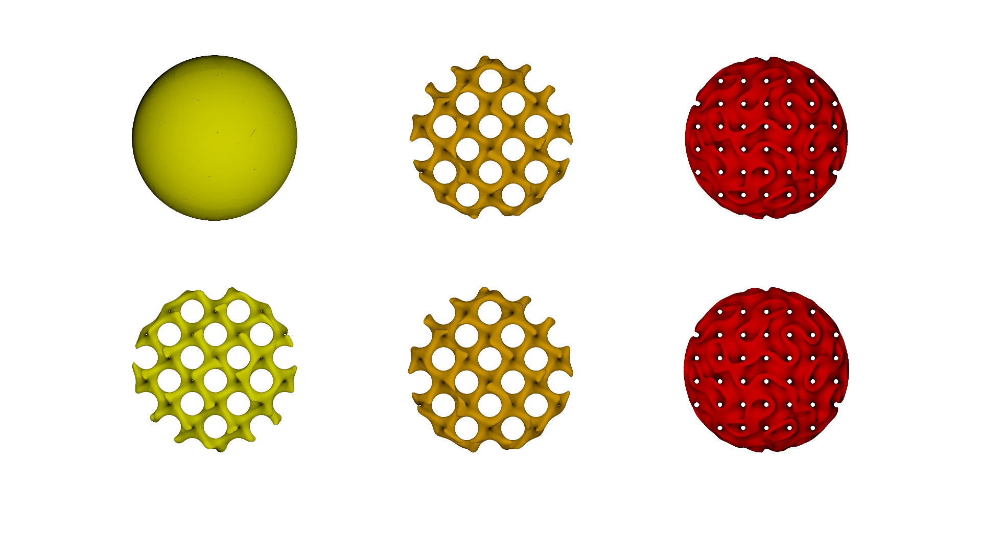

From: MichaelJF
Subject: Re: Condition in functions
Date: 16 Dec 2024 23:25:47
Message: <6760fd4b@news.povray.org>
Am 16.12.2024 um 23:36 schrieb Bald Eagle:
> MichaelJF <fri### [at] t-onlinede> wrote:
> Hmmm.   It looks like maybe it's a sign issue?
> Inside and outside are switched?
> Try just negating the function and see what happens.
> I'm not sure if that might have to do with the left-handed coordinate system, or
> what.
> - BW
Sorry, I mixed up the image yesterday. Here is the corrected version.
It's even worse. Yesterday is was one of my tests to solve the riddle,
in which I had commented out the exponential term as a test:
#declare GyroidLatice_1 = function (x,y,z) {
    select(isoCondition(x,y,z),Iso2(x,y,z),1) - //exp(isoCondition(x,y,z)/5)
The actual version depicts the full expression without the comment.
The difference between the functions Iso2 and Iso3 is just a change of
signs and in GyroidLatice_1 the exponential term is subtracted whereas
in GyroidLatice_2 it is added.
Below you can find the POV-part of the code with the MathMod-Code within
the comments. Maybe someone else can spot the difference. The parameter
t from MathMod is not used in this examnple.
Best regards
Michael
#declare L=23/2;
#declare c=1/10000;
#declare Th1=5/10;
#declare Th2=-8/10;
/* isoCondition=(x^N+y^N+z^N-(L-1/10)^N)  (N=2)*/
#declare isoCondition = function(x,y,z) { x*x+y*y+z*z-(L-1/10)*(L-1/10) }
/* Iso =
    cos(x)*sin(y)+cos(y)*sin(z)+cos(z)*sin(x) */
#declare Iso = function(x,y,z) {
/* DFx=((Iso(x+c,y,z,t)-Iso(x,y,z,t))/c)
    DFy=((Iso(x,y+c,z,t)-Iso(x,y,z,t))/c)
    DFz=((Iso(x,y,z+c,t)-Iso(x,y,z,t))/c) */
#declare DFx = function(x,y,z) { (Iso(x+c,y,z)-Iso(x,y,z))/c }
#declare DFy = function(x,y,z) { (Iso(x,y+c,z)-Iso(x,y,z))/c }
#declare DFz = function(x,y,z) { (Iso(x,y,z+c)-Iso(x,y,z))/c }
/* Rapp=(x/sqrt(x*x+y*y+z*z)) */
#declare Rapp = function(x,y,z) {x/sqrt(x*x+y*y+z*z) }
/* "Iso2 =
    Iso(x+Th2*Rapp(DFx(x,y,z,t),DFy(x,y,z,t),DFz(x,y,z,t),t),
        y+Th2*Rapp(DFy(x,y,z,t),DFz(x,y,z,t),DFx(x,y,z,t),t),
        z+Th2*Rapp(DFz(x,y,z,t),DFx(x,y,z,t),DFy(x,y,z,t),t),t)
#declare Iso2 = function(x,y,z) {
    Iso(x+Th2*Rapp(DFx(x,y,z),DFy(x,y,z),DFz(x,y,z)),
        y+Th2*Rapp(DFy(x,y,z),DFz(x,y,z),DFx(x,y,z)),
        z+Th2*Rapp(DFz(x,y,z),DFx(x,y,z),DFy(x,y,z))
/* Iso3 =
    Iso(x-Th2*Rapp(DFx(x,y,z,t),DFy(x,y,z,t),DFz(x,y,z,t),t),
        y-Th2*Rapp(DFy(x,y,z,t),DFz(x,y,z,t),DFx(x,y,z,t),t),
        z-Th2*Rapp(DFz(x,y,z,t),DFx(x,y,z,t),DFy(x,y,z,t),t),t)
#declare Iso3 = function(x,y,z) {
    Iso(x-Th2*Rapp(DFx(x,y,z),DFy(x,y,z),DFz(x,y,z)),
        y-Th2*Rapp(DFy(x,y,z),DFz(x,y,z),DFx(x,y,z)),
        z-Th2*Rapp(DFz(x,y,z),DFx(x,y,z),DFy(x,y,z))
/* Iso4 =
    Iso(x+Th1*Rapp(DFx(x,y,z,t),DFy(x,y,z,t),DFz(x,y,z,t),t),
        y+Th1*Rapp(DFy(x,y,z,t),DFz(x,y,z,t),DFx(x,y,z,t),t),
        z+Th1*Rapp(DFz(x,y,z,t),DFx(x,y,z,t),DFy(x,y,z,t),t),t)
#declare Iso4 = function(x,y,z) {
    Iso(x+Th1*Rapp(DFx(x,y,z),DFy(x,y,z),DFz(x,y,z)),
        y+Th1*Rapp(DFy(x,y,z),DFz(x,y,z),DFx(x,y,z)),
        z+Th1*Rapp(DFz(x,y,z),DFx(x,y,z),DFy(x,y,z))
/* Iso5 =
    Iso(x-Th1*Rapp(DFx(x,y,z,t),DFy(x,y,z,t),DFz(x,y,z,t),t),
        y-Th1*Rapp(DFy(x,y,z,t),DFz(x,y,z,t),DFx(x,y,z,t),t),
        z-Th1*Rapp(DFz(x,y,z,t),DFx(x,y,z,t),DFy(x,y,z,t),t),t)
#declare Iso5 = function(x,y,z) {
    Iso(x-Th1*Rapp(DFx(x,y,z),DFy(x,y,z),DFz(x,y,z)),
        y-Th1*Rapp(DFy(x,y,z),DFz(x,y,z),DFx(x,y,z)),
        z-Th1*Rapp(DFz(x,y,z),DFx(x,y,z),DFy(x,y,z))
/* ThickIso2=(Iso4(x,y,z,t)*Iso5(x,y,z,t)) */
#declare ThickIso2 = function(x,y,z) { Iso4(x,y,z) * Iso5(x,y,z) }
GyroidLatice_1=if(isoCondition(x,y,z,t)<(0),Iso2(x,y,z,t),1)-exp(isoCondition(x,y,z,t)/5)
    select(isoCondition(x,y,z),Iso2(x,y,z),1) - exp(isoCondition(x,y,z)/5)
GyroidLatice_2=if(isoCondition(x,y,z,t)<(0),Iso3(x,y,z,t),1)+exp(isoCondition(x,y,z,t)/5)
#declare GyroidLatice_2 = function (x,y,z) {
    select(isoCondition(x,y,z),Iso3(x,y,z),1) + exp(isoCondition(x,y,z)/5)
GyroidLatice_3=if(isoCondition(x,y,z,t)<(0),ThickIso2(x,y,z,t),1)+exp(isoCondition(x,y,z,t)/5)
#declare GyroidLatice_3 = function (x,y,z) {
    select(isoCondition(x,y,z),ThickIso2(x,y,z),1) +
#declare G1 = isosurface {
    function {
       GyroidLatice_1(x,y,z)
    contained_by { sphere { 0,L-0.1} }
    threshold 0
    max_gradient 1000
    pigment { colour Yellow }
#declare G2 = isosurface {
    function {
       GyroidLatice_2(x,y,z)
    contained_by { sphere { 0,L-0.1 } }
    threshold 0
    max_gradient 1000
    pigment { colour Orange }
#declare G3 = isosurface {
    function {
       GyroidLatice_3(x,y,z)
    threshold 0
    max_gradient 1000
    pigment { colour Red }
Download 'zeige_ball01.png' (413 KB)

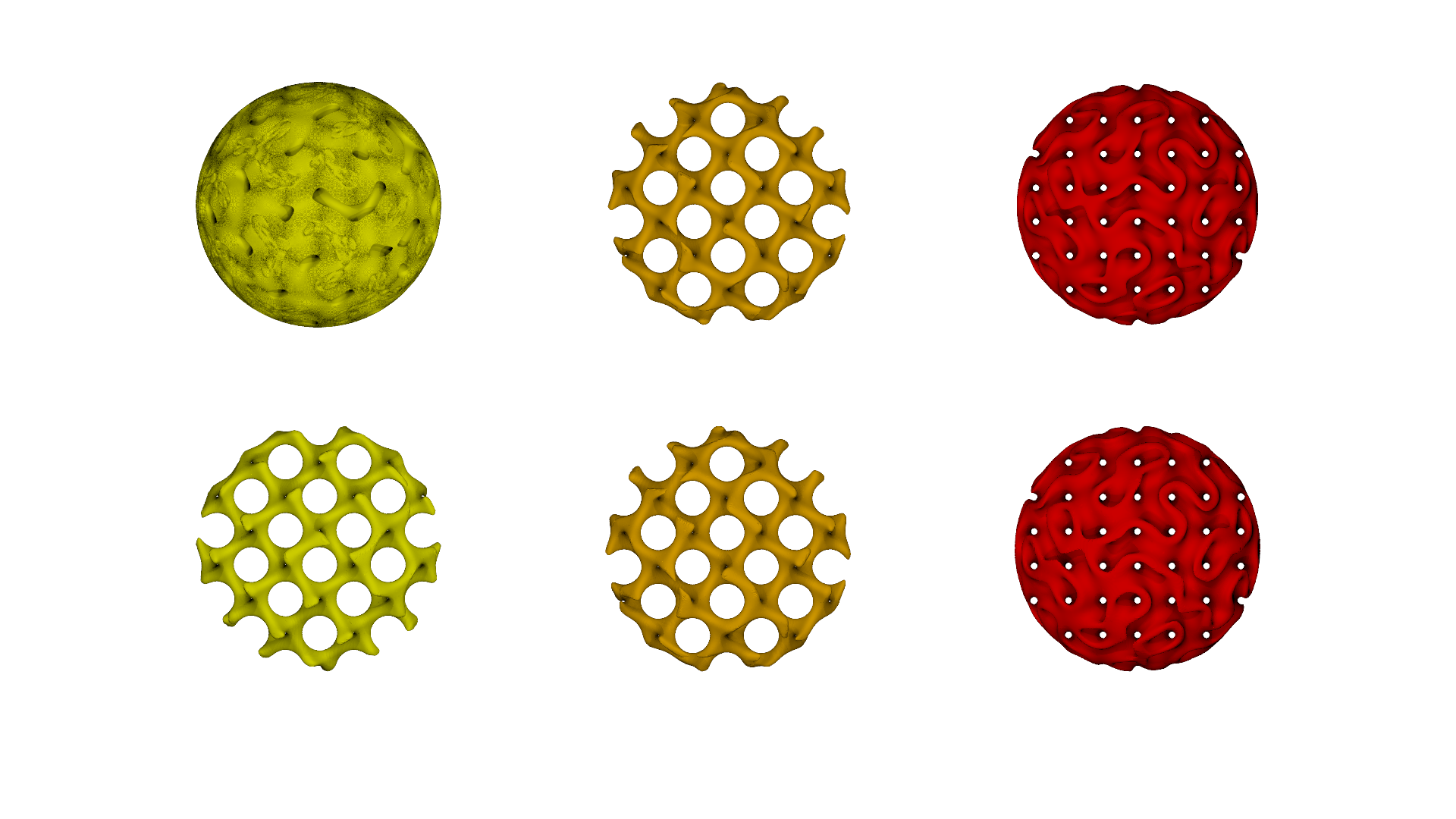

From: Bald Eagle
Date: 17 Dec 2024 06:20:00
Message: <web.67615d86320682331f9dae3025979125@news.povray.org>
Have you simply tried adding "open" to your isosurface block, so you don't see
the containing sphere?

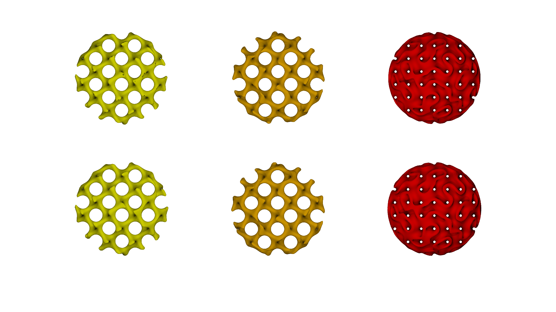

From: MichaelJF
Date: 17 Dec 2024 09:34:10
Message: <67618be2@news.povray.org>
Am 17.12.2024 um 12:16 schrieb Bald Eagle:
Thanks, that solves the riddle. In a way, you have to look at the
surface from the "inside" of the object. I can't remember ever having
consciously used this option.
Download 'zeige_ball05.png' (424 KB)
Preview of image 'zeige_ball05.png'
From: Bald Eagle
Date: 17 Dec 2024 16:15:00
Message: <web.6761e99232068233471fd7cd25979125@news.povray.org>
Sorta.
I think it has more to do with the extent of the visible surface:
https://wiki.povray.org/content/Reference:Isosurface
"When the isosurface is not fully contained within the contained_by object,
there will be a cross section. When this happens, you will see the surface of
the container. Using the open keyword, these cross section surfaces are removed,
and the inside of the isosurface becomes visible."
