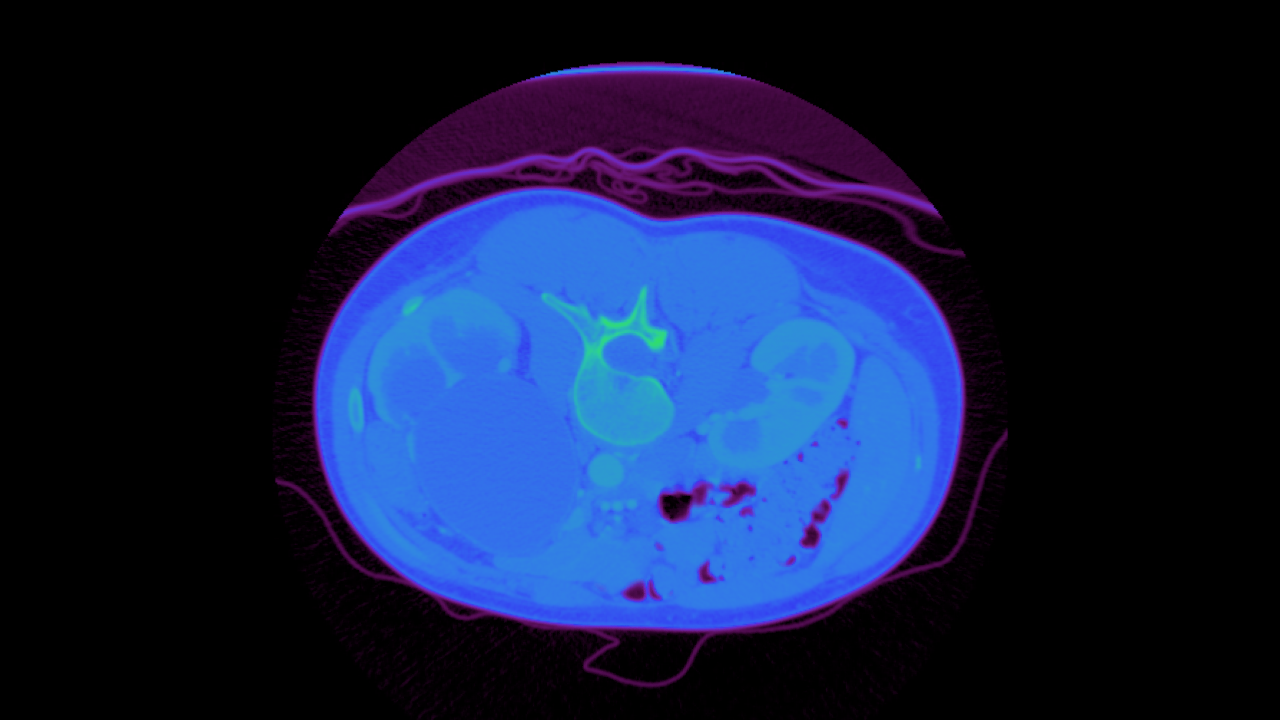

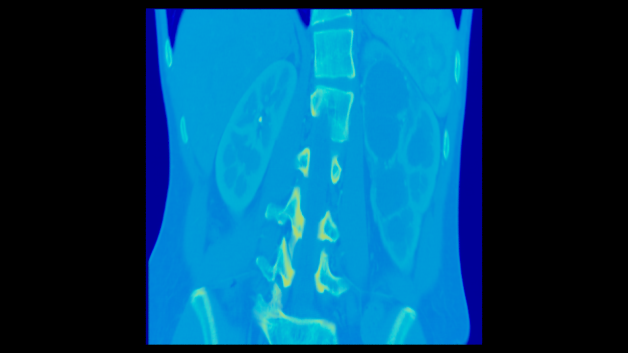

Unfortunately here still no success (please see 1st attached image).
It looks like scaling / translation issue - I will try to fix it.
In any case slicing by orthogonal planes by changing the box size
(as on 2nd image) will be enough - CSG operations was only exercise for
me. And now I believe - the media is really tricky :)
YB

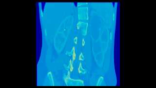

On 24/09/2024 20:40, yesbird wrote:
Can't resist to share a pair of beautiful slices produced by simple
box resizing.
YB

From: jr
Subject: Re: Slicing media - is it possible ?
Date: 28 Sep 2024 09:50:00
Message: <web.66f808e1d5a4caf1f5bfc9b06cde94f1@news.povray.org>
hi,
> box resizing.
agree, nice, dicom_3 in particular.  thanks.
