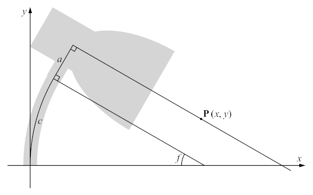

I want to aim a desk lamp by specifying where it should point.  P(x,y)
is where to aim the lamp, c is the length of the flexible part of the
neck, a is an additional rigid distance to the central axis of the lamp
hood, and f is the angle to bend the neck.  The initial equation was
huge and ugly, but I managed to simplify it considerably, to this form:
  (x - c/f) * sin(f) + y * cos(f) = a
But now I'm stuck.  Variables a, c, x, and y are given, and I need to
solve for f.  I plugged it into Wolfram Alpha, but it gave up.  I don't
even know if a paid subscription would find a solution, and I would
hardly use the service enough to justify a subscription anyway.  Does
anyone have an idea of how to proceed with the equation?  Or should I
gamble that Wolfram Alpha Pro can solve it and pay for one month?
Download 'flex_lamp_problem.png' (19 KB)
Preview of image 'flex_lamp_problem.png'
From: kurtz le pirate
Subject: Re: Stumped by desk lamp trig equation
Date: 6 Aug 2022 13:32:06
Message: <62eea596$1@news.povray.org>
To test your equation, I replaced the a, c, x and y by numerical values.
Wolfram solve the equation but only numerically because apparently there
is not only one solution...
<https://www.wolframalpha.com/input?i=solve+++%283+-+4%2Fx%29+*+sin%28x%29+%2B+5+*+cos%28x%29+%3D+2>
Puzzled !
Kurtz le pirate
Compagnie de la Banquise

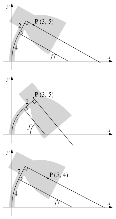

From: Cousin Ricky
Date: 6 Aug 2022 17:57:21
Message: <62eee3c1$1@news.povray.org>
Does this imply that I would need to program a numeric solution into my
macro?
I'm only interested in solutions between 0 and pi/2.  The plot of the
solution implies that there can be no more than 2 of these.  With your
example, I'll naturally want the smaller angle, as the larger angle puts
the aim point behind the lamp!
By pushing the aim point farther from the lamp (the bottom plot), I get
only 1 solution.  I'm still trying to work out how to restrict inputs to
the macro to guarantee only scenarios that make physical sense.
Download 'flex_lamp_problem-a.png' (20 KB)
Preview of image 'flex_lamp_problem-a.png'
Date: 7 Aug 2022 10:59:13
Message: <62efd341$1@news.povray.org>
> macro?
I am afraid that it is not possible to solve literally an equation which
makes appear at the same time t, sin(t) and cos(t). A bit like in
differential equations with x and dx.
Literal solutions never exist (except for school cases).
Another trail.
Let sin(x) = T and cos(x) = U, the equation becomes :
(g - c/x)T + hU - a = 0
Wolfram proposes a more "usable" result.
<https://www.wolframalpha.com/input?i=solve+%28g+-+c%2Fx%29T+%2B+hU+-+a+%3D+0>
x = cT/(-a+gT+hU) with a!=gt+hU & cT!=0
Maybe more adapted to your needs ?
Kurtz le pirate

> Anyhow, as I showed in p.b.i, I did solve the problem.  Taking Kurtz's
> word that there is no analytic solution, I wrote a solver, and it works
> beautifully.
I'm back from vacation and this topic is tickling me ;)
Just for fun, I implemented some macros to find the roots of functions
that cannot be determined formally.
I used the methods of Bisection, False Position, Newton Raphson, Secant
and Steffensen
If anyone is interested ...
Kurtz le pirate
