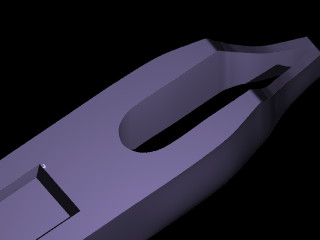

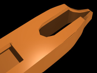

Hi Lutz,
as i mentioned in the thread before, i want to export a hamapatch to
moray, in order to work with the created object in moray. One of my
first ideas was, to export the file to spatch and then using your spatch
plugin to get anmoray object. So far, it works fine. But there seems to
be a little problem with rounded edges (see attached pics). Is there any
work arround?
best wishes,
Robert
pic 1: directly exported to povray
pic 2: exported to spatch, exported to moray
BTW, i have the same problem, when i start directly with spatch, without
using the converted file from hamapatch
Download 'hama_to_pov.jpg' (10 KB) Download 'hama_to_spatch_to_moray.jpg' (14 KB)
Preview of image 'hama_to_pov.jpg'
Preview of image 'hama_to_spatch_to_moray.jpg'

> But there seems to be a little problem with rounded
> edges (see attached pics). Is there any  work arround?
It seems like a problem with the U or V steps as well as the flatness.
Try this:
First try decreasing flatness (to say 0.0001).
If that doesn't help enough, also try increasing U and V by 1 or 2.
You could also take a look at the POV file that hamapatch directly
exports and look what Hamapatch exporting for the U,V and flatness
values and use those on the Moray patches.
- Lutz
  email : lut### [at] stmuccom
  Web   : http://www.stmuc.com/moray
From: Robert Günther
Subject: Re: spatch plugin -> Moray
Date: 28 Apr 2001 12:25:04
Message: <3AEAEF17.52A8D697@exmail.de>
Hi Lutz,
Thanks for quick help. But it doesn't work....
Did it. No visible changing...
Ok, tried it. But nothing has changed... Here a part of the pov-file,
exported from hamapatch....
union{
 bicubic_patch {
  type 1
  flatness 0
  u_steps 3
  v_steps 3
  <0.500, 11.750, -43.750> <0.500, 11.525, -44.938> <0.500, 10.930,
-46.455> <0.500, 10.465, -47.571>
  <0.500, 11.750, -43.750> <0.500, 11.594, -44.570> <0.783, 11.082,
-45.656> <0.783, 10.616, -46.772>
  <0.500, 11.750, -43.750> <0.500, 11.594, -44.570> <0.783, 11.166,
-45.351> <0.783, 10.848, -45.549>
  <0.500, 11.750, -43.750> <0.500, 11.820, -43.382> <0.500, 11.318,
-44.551> <0.500, 11.000, -44.750>
best wishes,
Robert
Date: 29 Apr 2001 07:22:06
Message: <3AEBF99A.A3667340@exmail.de>
> Hi Lutz,
Ok, i didn't gave up.
The hamapach exported povray values for flatness 0, u_steps 3, v-steps 3
don't work! (strange).
But changing the values in moray to flatness 0, u_steps 1 and v_steps 1
work fine for me.
best wishes,
Robert
