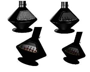

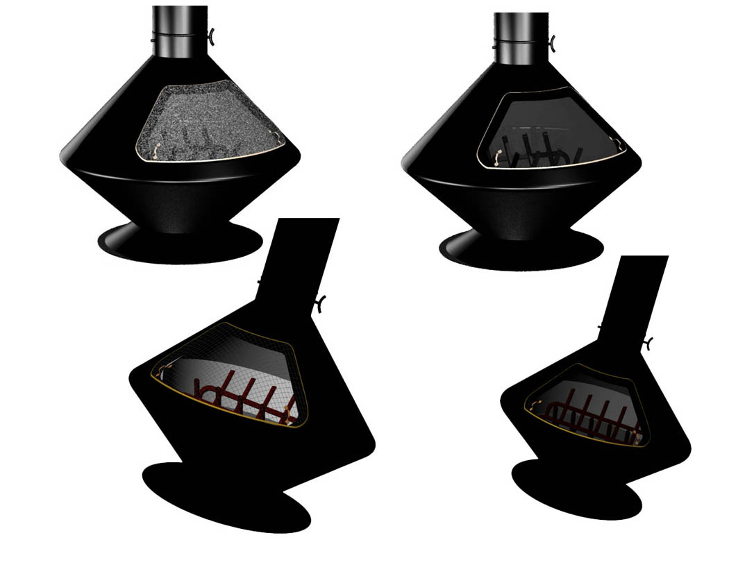

Hello all,
I'm modeling an interior scene in Rhino 1.1  that contains a small wood
stove type fireplace.  The stove has a screen over it's opening.  I'm
debating on whether to create the screen with simple geometry for realism,
or to find a shader with opacity and displacement mapping.
My question to this group would be: Is there a shader available within
Moray/povray that would allow me to see through the screen to the interior
of the fireplace?

It looks like I've stumbled over a problem area.  My goal would be to be
able to see through the screen to the objects inside the stove like the
grate and maybe a log or two, just as in real life.  It seems that a shader
over a surface would be opaque.  Could make a fret work of  small pipes from
arrayed lines. Using fewer than normal pipes.   I'm not sure I understand
the use of the alpha channel and how it might be employed  in Moray which
I'm using.  Perhaps this is something I should study up on.

I like the "opacity map", 'image_map' in the case of using POV-Ray, with a
'bump_map' idea the last person had said.
That way you'd just be using a texture by using one premade image put into the
image map and bump map to create the effect.  Real simple.  Something like a
woven cloth pattern perhaps where the spacing is one color for the 'transmit' of
it's index number.  The opaque "threads" being from near black to white for the
bump mapping, giving the screen more 3D depth.  I think the trouble in doing
such a thing (from experience) is the need for plenty of see-through space

I'm doing my modeling in Rhino 1.1 and am rendering with Moray/Povray.  I'm
kinda new to the rendering end of things and don't really have a clue toward
getting custom results in this package yet.  But it seems that I should be
able to create a custom shader to my liking with the tools in Moray.
Anyway I've been doing some experimenting with getting a convincing screen
shader and have come up with a few different results.  I hope that this
system can handle a 72.8K attachment. If not I trust someone will tell me
and I won't do it again.
The upper left image is modeled in Rhino and rendered in Moray.  The screen
material, which is the point of all this is a color map texture applied to a
single surface.  Looking for anything that might be close to what I need, I
came across the candy cane texture in the library of textures and modified
it by adding stripes, changing the colors and adding transparency to half of
the stripes, then I changed the noise pattern to granite.  The result is not
what I'm looking for but offers hope that further experimentation will help.
The upper right image is modeled in Rhino and rendered in Moray.  The screen
material is a glass shader applied to a single surface.  I've set the color
to a dark tone and and reduced the reflection.  I don't find this very
distracting and would probably go with it if I don't come up with a better
texture map.
The lower left image is modeled in Rhino and rendered in Rhino.  The screen
material is actual geometry.  I think this looks closest to real, but the
overhead is prohibitive.  I knew this in advance but I wanted to see how
actual geometry would look.  I wonder if I couldnt use this image in
PhotoShop to create a texture map somehow and apply that map to the single
surface while in Moray?
The lower right image is modeled in Rhino and rendered in Rhino.  The screen
material is a single surface with a dark color tone set to it and a
transparency of 40%.  I don't find this distracting either, but have to note
that Rhino is a modeling program.  The rendering function within it is just
to help visualize modeling results.  It is expected by Rhino's creators that
we users will find a suitable renderer.  Which is what brings me here.
Thanks everybody for your input.
later,
Steve

Steve Clarke wrote:
> I hope that this system can handle a 72.8K attachment. If not I
> trust someone will tell me and I won't do it again.
Don't do it again :)
The system can handle it but we prefer that you put binary attachments
like this in the moray.binaries group on this server. After posting it
there you can reference the binary file in your message in this group
so that people know where to find it.
